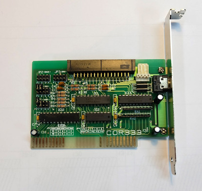

I think you already solved all, but I have one ISA controllers for that interface,:it iss an ISA controller for that specific
CD-ROM - Corion Industrial Corp COR333 (I have the cable 34-pin original also).
Unlikely my SONY CDU33A-01 is KO, pressing the eject button have the "drawer" stuck (cannot say it correctly in English),
so I cannot load CD-ROM support 🙁
For this I am going to throw CD-ROM drive into the trash bin and I am going to sell the ISA controller.

The problem is not a mechanical issue but unluckily an electrical one... 99% due to electrolytic capacitors.
After 20-25 years they usually break down: all IBM ps/2 Intel 8088 with no hard drive and only 2 x floppy disks have today both FDDs broken and the problem (well documented also here in VOGONS)
is that two manufacturers building those drives for IBM used the same type of capacitors, and they all broke after 15 years approximatively.
The eject function mainly is driven by a little IC, so even if all capacitors are refreshed, you have to check the integrity of IC (identify/unsolder/find/purchase new one, and so on).
Only rarely the eject issue is due to a plastic belt lack (mechanical issue) but unfortunately the "drawer"stuck issue is coupled to a "bad blinking" green led sequence... so it is an electrical matter
and fixing is not cheap... only after doing this you have to check if the drive lens is still aligned good, you would risk to repair the drive and then not to read media support! 🙁
