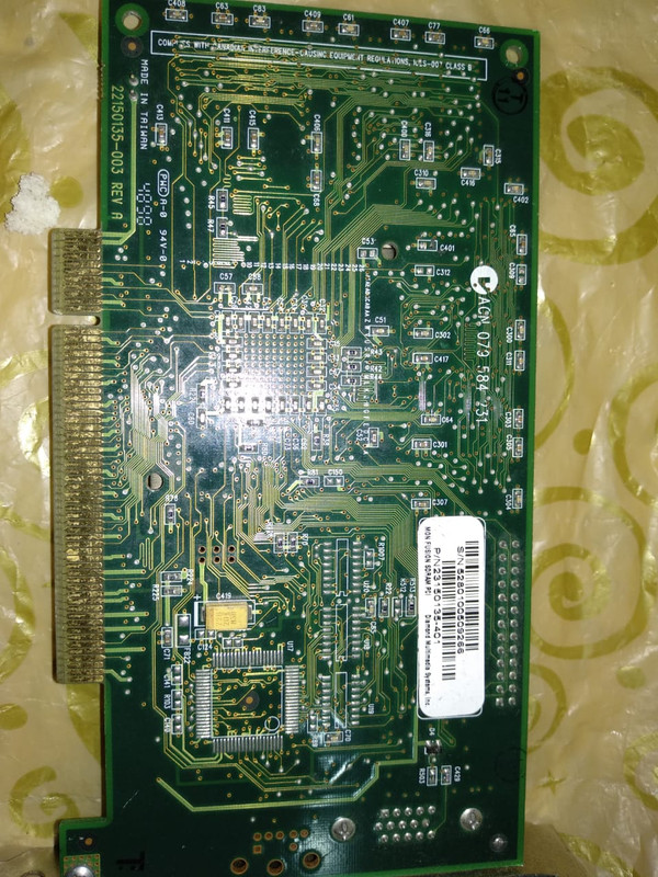

Got this card today, it works on DOS so far (i tried it for a little bit without windows) but looking closely at the card on the back it is missing some components. I was not able to find HD images of the PCI version, if anyone has it and can take a picture i really appreciate. model is DIAMOND MONSTER FUSION PCI
even tho one of the components marked in Orange ...i belive a copper trace was removed and i will never know where that went to.

All of these look like bypass capacitors so any 0.1µF+ 0603 ceramic is gonna work there.
