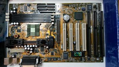

I have a problem updating BIOS on my Asus P2B rev. 1.04 - always fails on one of two addresses during verification process.
Used both Aflash 1.37 and 2.21
Tried Bios 1012 and 1014.003
Funny is that when I try to flash back to the old BIOS it also fails on those addresses for the couple of runs and then it flashes successfully.
Also I'm not sure if Aflash should display new Bios after flashing - when changing from 1012 to 1014 still 1012 is shown as motherboard Bios.
Basically I have Bios version 1012 so its not bad, but someone put a subversion with no hardware monitor - however maybe that is the case and I should use 1014 without hardware monitor also.

Hah - finally it failed to flash permanently, then I bought a TL866 programmer and got the same error (same address). So the BIOS chip is broken - need to buy a new one.
Funny part is that, despite flashing error, system boots up - everything looks fine - I've got HW monitor in BIOS. Will need to test a little bit to make sure.
I'm trying to fin an answer if I can use any 2MBit EEPROM flash - 120ns or faster than original (AT49F002NT-120PC).

Reply 8 of 35, by varrol
Bought WINBOND W29C020C, flashed with the latest BIOS (1014.003) - working fine.

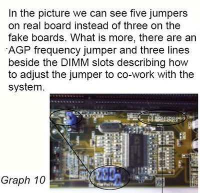

Reply 11 of 35, by zyga64
Asus P2B 1.04 is probably fake (according to Asus).
    FAKEP2B.PDF

Reply 16 of 35, by varrol
Wow, it seems I had a fake P2B - I had no idea they can be counterfeit. I no longer have it - sold in favour of P3B (and I suspect one of my P3Bs is counterfeit too) - but got some photos.
Amazing - it was so well made - really nice quality - mine was like brand new and worked flawlessly (besides BIOS chip - I no longer have original BIOS dump).

Reply 17 of 35, by auron
that fakep2b.pdf is quite something... if the known fake boards at the time of writing were 1.04 marked, why even do a comparison with a 1.10 board instead of a genuine 1.04 one? unless fake and genuine 1.04 boards are literally impossible to tell apart (beyond that serial number sticker maybe), but given the awkward wording here it's hard to make much sense of what aspects are specific to fake boards.
wonder what even happened here, did an employee leave and leak the schematics or something?
Reply 18 of 35, by PARKE
Some of the chosen examples to show the differences are indeed awkward.
For me the most compelling aspect is the frequency selection jumper set; instead of a 4-pin jumper block plus a separate AGP jumper there are only the 3 jumpers of the earlier board versions.
The board layout chosen by the counterfeiters is practically identical to rev. 1.02.
