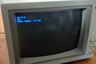

Reply 4 of 10, by Deksor
Well ...
1.21 MiB
268 views
890.58 KiB
268 views
It works flawlessly ... (floppy read is showing an error because I didn't plug any floppy drive)
It seems like that board acts dead if I use my VGA card (which I've tested on a 8 bit ISA slot), but with MDA it's perfectly fine !
Problem solved I belive ? (Thanks again for your help 😁)
Well ... like I mentionned, I have two boards, the other one still acts dead (nothing happens even on the POST card), no beeps, nothing with the landmark ROM, nothing with the BIOS.
I may have a clue though, I think that the fan spins quite fast with that one, so there may be some more bad caps in there (on the +5V I think)

Reply 6 of 10, by Deksor
Thanks, but unfortunately it's not working very well, the picture itself is ok, but the colors are brighter on the left than on the right and they fade to the right. And R, G, B aren't affected the same. They're all affected, but red seems to be the most affected color.
I have no idea what does this nor how could-I fix that.

Reply 8 of 10, by Deksor
Hard to say since things tend to be more blurry on crts when it's too bright. But I'd say (though I'm not sure) that this is the brightness.
alternative
Reply 9 of 10, by Deunan
Likely not a HV issue then. Although any CRT monitor repair should start with re-soldering each and every pin on the flyback transformer.
If geometry looks OK-ish then it's probably a capacitor issue somewhere in the cathode drivers. Shorts and weak tubes typically have a single color going missing or the whole picture brightness is affected. Replace all electrolytic capacitors on the neck board, if that doesn't help, the main board as well. Don't skip the low value ones (1-10uF or so), these too dry out and cause all kinds of problems.
