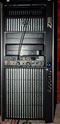

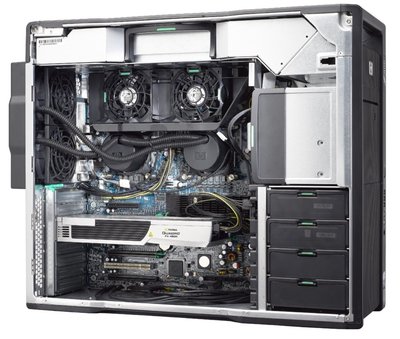

I had WinXP pro running on a HP Z800 ( HP provides drivers for this ), It’s was Dual quad core Xeons at 3ghz. ( 8–cores and 16-threads total ). With 48gb of ram but could support up to 128gb of ram.
And an Nvidia GTX 960 , Nvidia has XP drivers for this.
https://www.nvidia.com/Download/driverResults … px/105040/en-us
With a PCIe SSD drive.
It ran very stable and fast and supported all CPU cores and ram.
