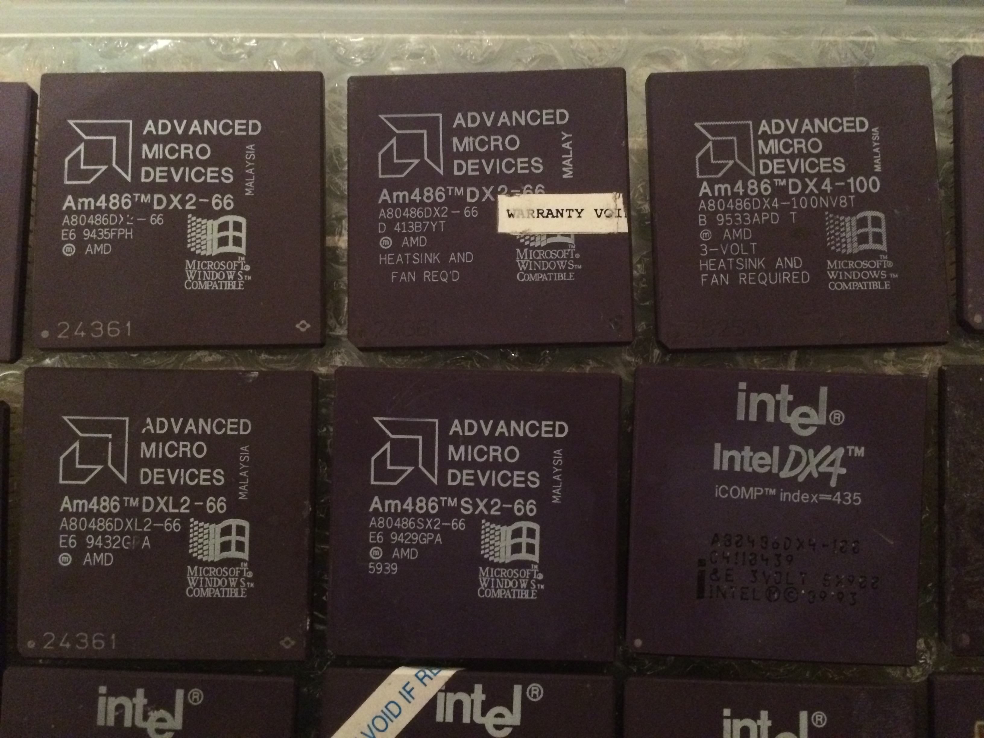

Reply 26 of 39, by Deunan
treeman wrote:
looking at that picture what's the difference between amd dx266 and dxL266? they look very much the same except the L
That's early 3V3 devices from AMD. Later they've changed the product code to include letter V (like Cyrix did and all their clones/copies) to indicate it's a lov-voltage CPU.
