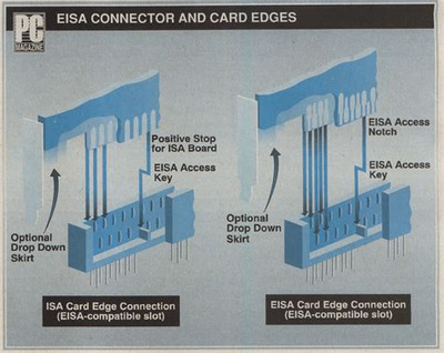

Edit: I'm afraid there's a misunderstanding. 😅
I ddidnt mean that tth Amiga's Zorro bus itself should have been replaced by EISA..
I meant the ISA portion behind it (can hold EISA/ISA/XT bus cards) could have been upgraded to EISA.
I think it would have been nice if Commodore did sell upgrades for the Amiga 2000's Zorro/ISA backplane (or rather, logic board).
As a semi drop-in replacement (if chips were socketed.)
These new backplanes would have had Zorro II/III and EISA connectors.
Because, I think, EISA didn't require a very long bus slot (as VESA's VLB did).
For adding VLB in the same way, the Amiga 2000 's chassis and motherboard were too small and tight (see pic).
But that's not the case with EISA slot - it had the same dimensions as the Zorro II/ISA connectors.

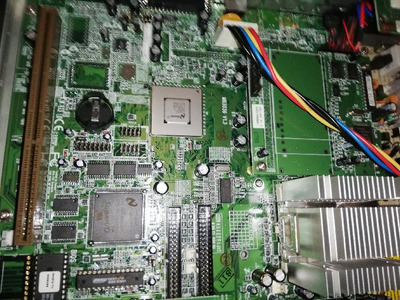

In fact surplus EISA connectors were still used in the late 90s/early 2000s.
Set-Top boxes like the Surfstation JNT used them for combined ISA/PCI backplanes.
That way, the Amiga owner could have kept the existing Zorro II/ISA bridgeboards
and PC emulator boards, withoutany advantages or disadvantages.
But if more performances was needed, the lower row (EISA part) of the edge connector could have been used by hardware that supports it.
Or which did find it useful (EISA devices used IDs and config files on floppies).
(Edit: PC emulator boards with EISA support could have had contained an internal database with a selection of popular config file data.
This approach could have been much more conveniant than on a real PC.)
Or in simple words, the native, 32-Bit component of EISA could have been used in a special way (if needed, I'm just a layman).
Or EISA could have been used as a reason to backport Zorro III to the A1500/2000 platform.
With EISA, there technically was a nice companion to interface with and both the classics would have been fully 32-Bit (slot wise).
Anyway, this was just a Gedankenexperiment (what if). There also was Microchannel, too. In both 16 and 32-Bit flavour. 😉

What I meant to express, at the very heart of it :
- It would have been an interesting idea to physically replace the ISA slots ,- which were used by bridgeboards-, by EISA slots.
- Because, EISA was a super set of ISA (two rows; ISA and native EISA), the official successor of ISA and because the connector fits nicely in the same spot.
Not much redesign would have been necessary. In case it didn't catch on, nothing would have been lost.
Except that Commodore spent a bit more money on high quality expansion slots with better specs.
- The whole logic thing would then have been up to the bridgeboards side (PC emulators).
This would have been super easy. EISA used a parallel bus, just like ISA. PCI slots on the other hand, are not equal.
Again, competing third-party companies would have had to implement EISA logic on their bridgeboards, not Commodore.
Except if it wanted to (making a new A2386SX alike board with a 486DLC).
If the user decided to keep the old expansion cards, all the ISA wiring would remain the same.
But with matching hardware, say, EISA bridgeboard (based on 386/486DLC CPUs which have a 32-Bit frontside bus), an EISA ethernet card etc.
the PC side could handle a lot of i/o in a smoother way, or at least without the ISA bottleneck.
Pure ISA hardware could also have been thrown into the mix, like a LAPC-I, an industrial controller, a transputer device, a chess card..
