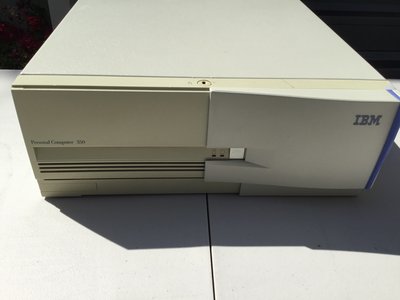

It's a cool machine so you shouldn't be worried too much.

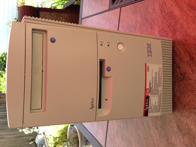

Reply 9 of 42, by Intel486dx33
I would look for an IBM 350 desktop or IBM tower Aptiva with win98 logo. A AMD K6 or Pentium CPU.
They are NOT proprietary hardware and easy to work on and inexpensive to buy and upgrade and fix.
