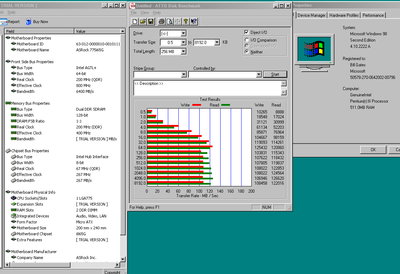

There are motherboards running the Intel 865 chipset with SATA ports which natively support Windows 98. Let me know your benchmark of choice and I can give you some results.

mothergoose729 wrote:
I use this benchmark from Phil's website: […]
https://www.philscomputerlab.com/hdd-benchmarks.html
I am curious to see what you get, but at this point I am committed to a chip set that doesn't appear to have SATA drivers for 9x. If I give up and go socket 478, the 845 or 865 chipset is definitely what I would get.
I assume you wanted the ATTO benchmark, ran with defaults on an old Intel 60GB SSD (underclocked 45nm Pentium dual-core).
Those results are basically perfect. I think 122mb/s is about the upper limit of SATA I.
Also, didn't know that the 865 chipset will take pentium dual cores! That really seems like the ideal setup for windows 98.
Not many 865 boards will happily accept 45nm socket 775 CPUs but the Asrock 775i65 has official support. FSB1066 support is a 166mhz fudge not running at 1:1 ratio, 800mhz bus chips work out faster so the 45nm pentiums are just the ticket and can be picked up for peanuts. This one is running at 2.4Ghz rather than 3.2Ghz to avoid issues in DOS but the underclock makes negligible difference to power consumption or temps.
