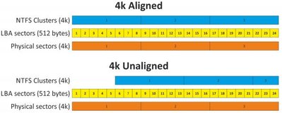

An AF HDD can't read/write units of 512Bytes per sector directly anymore, but only a group of them (8 pieces = 4K; plus some ECC information).
Since the classic OSes use the old 512Bytes/Sector scheme, the drive must combine 512Byte sectors during write or extract them during read (hence 512e).
In a bad situation (misalignment), it can happen that logical and physical sectors do not overlap each other.
In that case, the HDD has to do twice the work (read/write a pair of 4K sectors.)
On the bright side, NTFS uses 4K clusters which match both the 4K sector format and the Windows memory scheme
(32-Bit/64-Bit Windows uses 4K segments; Windows 3.1 on a 286 used 64K segments by comparison..)
    26.87 KiB
    1577 views
    Source: https://www.minitool.com/lib/4k-alignment.html
