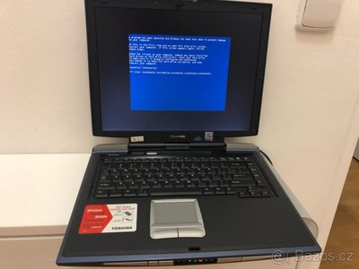

I wanted one of those satellite laptops especially a25-s207 since it has desktop cpu,win 98 drivers,one is locally for 35 USD, it will be mainly for year 1997-2001 gaming.
However the one thats listed is for parts only, otherwise it is in mint condition, I want to ask what could be wrong with the laptop based on windows blue screen. Memory or HDD maybe ? 😕
I just can't decide 😊

    This is where it locks up.

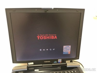

    It seems to POST ok so i guess the motherboard is alright ?

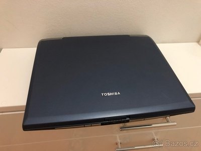

    It's in good condition, no cracks and every screw is inlcuded.

Or maybe it's just windows that's have been trashed by years of crapwares and malwares, and the owner doesn't know or want to bother to fix it and thus he presents if "for parts".
To be entirely sure, why not just ask him what's wrong ?

In my experience there's about an 80% chance it's fine, but that 20% is money pit time.
Find out what the fourth symbol on the diagnostic screen is, it seems to be the one crossed out. It might be RAM, but if it had no RAM you wouldn't get the other error message.
The error message implies it can't read the drive, if you're lucky it's the drive, if not it's the drive controller.
I hope it has a power supply included.
It all depends on whether $35 is a lot or a little for you. If it's a little, go for it, it's nice to have a clean case, screen and keyboard on a project laptop.

It works 😊 the HDD sounded like jet engine, I threw it away, put an original 40gb toshiba replacement disk in and it works like champ 😀 (however its slooooow in 3D games, like really slow) 😁
