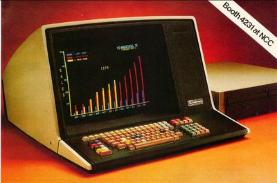

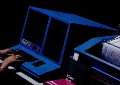

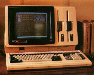

Imagine one of these as a 3D printed case with an LCD, Cherry MX keyboard, and this motherboard (and I figure one of those small-form-factor PSUs):

*Too* *many* *things*!
Reply 14 of 42, by root42
Yeah, if we now had someone making nice desktop cases, with 3.5“ and 5.25“ drive bays. That would be nice. We could make our own Vogons PCs.

These pictures do remind me of the VT100 terminals from the 1970s. Before computer equipment got degraded to consumer products.
Some versions or clones had CPU boards installed, making them able to run CP/M (VT180 model) and other microcomputer OSes of the time.
PS: I wished orange plasma screens were still available. Or hi-res monochrome LCDs with electroluminescent backlight.
Or OLED displays, at least. Modern LCDs are so sterile and boring by comparison.
Edit: Sorry for being off-topic. The mainboard looks well made, indeed, 😄
