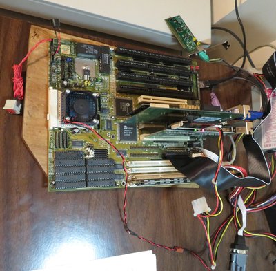

Unfortunately, I already moved HOT-433 v4 board off the test bed in order to test HOT-433 v1. The v1 board has a different layout from v4. Version 1 of this board has an older AWARD BIOS option and a newer WINBIOS option.

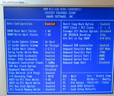

a) AWARD BIOS - 433AUS23
b) AMI WINBIOS - 433AUS2C

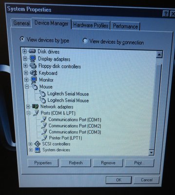

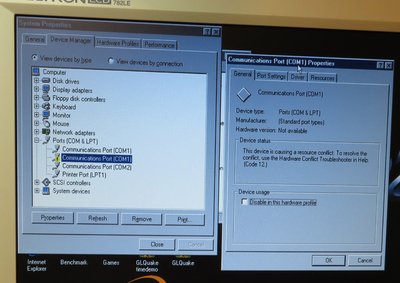

When COM1 is disabled with the AWARD BIOS, it stays disabled in Windows 95 Device Manager. When COM1 is disabled with the WINBIOS, COM1 is NOT disabled in the Device Manager. And in the case of the WinBIOS on the HOT-433 v1 (contrary to the HOT-433 v4), I cannot have the emulator card enabled on COM1 without first disabling COM1 in Windows Device Manager, otherwise, the system hangs on boot (same case with NexGen system).

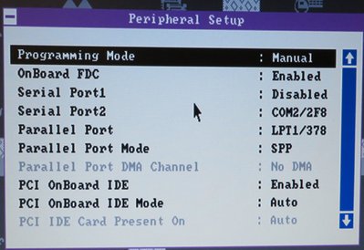

However, and contrary to the NexGen system, I was allowed to change COM1 in BIOS from 3F8 to 3E8, and Windows Device Manager now shows COM1, COM2, and COM3 - and the emulator card still is working on COM1. Again, this didn't happen on the NexGen board, which for the same conditions, crashed shortly after loading the desktop.

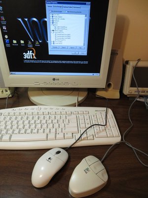

This shows HOT433-v1 with WINBIOS COM1 set to 3E8. All 3 COM ports how up - COM1 has the emulator, COM2 has a standard Logitech Serial Mouse. I can use both mice at the same time and did not observe any lag with the emulated mouse compared to the real serial mouse.

This concludes my testing of the RIO444 PS/2-to-serial port emulator card. I'm packing it all away now. Depending on your system with WINBIOS, you may have some extra steps to fix - be it switching the MB's COM1 to 3E8 to turn it into COM3, or if that does not work, like with my NexGen board, then you may have to disable the motherboard's second COM1 port in the Device Mananger prior to using the emulator card. You could also get lucky as with HOT-433 v4, who's BIOS allowed the emulator card to take over the motherboard's COM1, even though COM1 will shows up in Device Manager when it is disabled in BIOS and without the emulator card plugged in.
