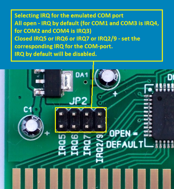

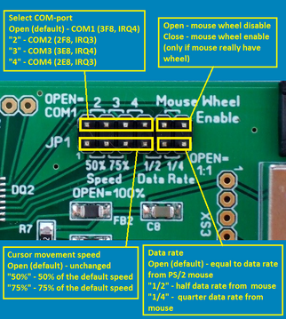

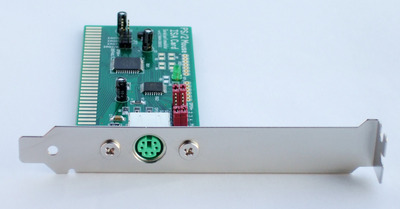

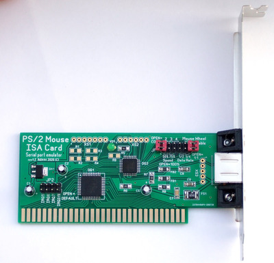

Now adapters has a new revision - 1.2 .
Changes in revision 1.2 compared to revision 1.1:
- added support for Windows 2000 and Windows XP,
- changed layout of jumpers and marked position of jumpers to select COM3 and COM4,
- removed data rate divider 1/3 (only 1/2 and 1/4 remain),
- added the ability to select any IRQ from the range 5, 6, 7, 2/9.
