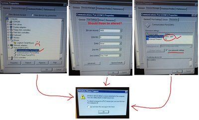

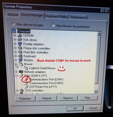

Did you have a chance to view my screenshots in the other page of this thread? If I disable COM 1 in BIOS, Windows 95c still wants to re-introduce COM 1 as a port. And the mouse mistakenly gets assigned to IRQ 9 with address 023C, which is not IRQ 4, 3F8 as it should be.
Windows 95 should introduce port COM1. But, if this port is disabled in the BIOS, and the adapter is installed, then COM1 will be the adapter.
Please enable COM1 in Windows and manually configure the port settings 3F8, IRQ4.
Disable-COM1-in-Windows95-for-mouse-to-work.jpgThat is how it should be:ann1999050111.gif

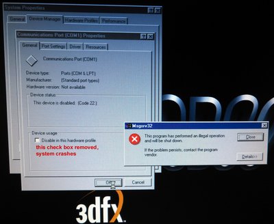

What you are suggesting is not possible on my system. I believe that enabling COM1 in Windows 95c is enabling the RS232 hardware on the motherboard and it is conflicting with the IRQ and address of the emulator card. COM1 in Windows 95c must be disabled on my system for the mouse to work. I'm not sure if my system is just particular, or your system is overly relaxed in this regard.
In the photos below, I am showing that COM1 is on the same address as the emulator card. Then I try to re-enable COM1, and the system spits out error messages, then hangs.

Which version of Windows 95 did you test and on which motherboard?

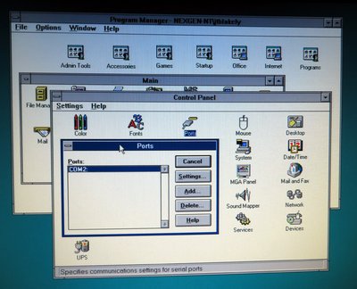

On the same system, Windows NT 3.51 does not contain COM1 as part of its ports list. It removed COM1 once I installed the emulator card, which is the opposite of what Win95c does.

The automatic setting keeps COM1 as IRQ 4, 03F8.
The RS232 ports are built into the motherboard. The motherboard is a NexGen Nx586 with PF110 CPU.
The 4 others testers of the emulator card were able to leave COM1 enabled in Windows 95c? And they still have COM1 setup as IRQ 4, 3F8 in the Windows95 ports section? What are their port settings? Am I supposed to adjust them? It is hard to beleive that I'm the only one who has this problem. Does anyone else have the RS232 ports as part of the BIOS, rather than on an ISA card?
I'm not going to re-install Windows; it is way too much work for the uncertainty. I have all my software setup. I doubt the issue is my installation. The serial port works fine if I plug a mouse into it.

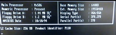

Attached is the POST screen. COM1 is disabled in the BIOS, and 3F8 shows up from the emulator card as expected. But if your set in BIOS to have COM1 enabled and run the emulator card on COM1, what happens in Windows? I suspect you will experience the problems I am having.

But most likely it disappears because the adapter is a new COM port. Therefore, it must be set again manually.
The reason is that the usual COM port works like a 16550 chip. And the adapter is like an older 8250.
Here I add a new COM1 port.
