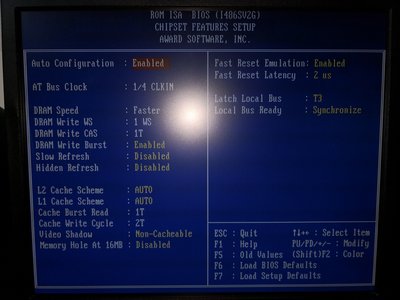

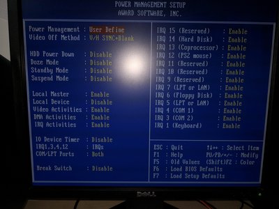

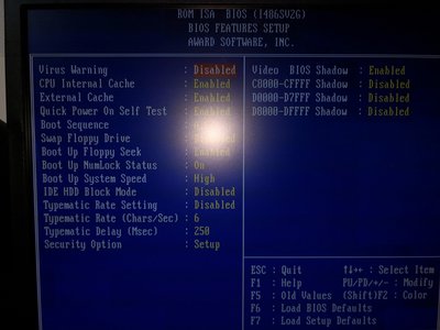

What FSB are you using and which CPU? What are your BIOS settings, in particular for the memory and cache timings, and using the Synchronise or Transparent option? What graphics card? How much RAM and how much cache? Single-banked cache or double-banked cache? Are you using an AMD X5-133 and trying to get write-back L1 cache working? The board requires a BIOS update for this. Depending on the graphics card and FSB, you might need to use Synchronise. Are you trying to use more than 64 MB of RAM? 64 MB is the max you can use on this board. Fastest cache timings might not work if you are using single-banked cache. Any of these can cause the issues you describe. But this is only a brief sample of scenarios for which there are dozens.
Reply 7 of 15, by skel2raw
I have attached pictures with the bios settings. The bios is the latest revision.
I have installed 1mb L2 cache, 64 MB Ram, FSB is 33MHZ.

Reply 8 of 15, by skel2raw
Galaxian wrote:
Oddly enough I'm in a similar boat. Different specs but I can't get past where it sets up the start menu items.
So I managed to figure out what caused the problem. It seems my memory was bad. I took out all the modules and just left one 16 MB module inside and now windows boots up without an error.
But now I have the exact same problem you do: The setup process is trying to setup the start menu and does not go any further. I can still move the mouse though.
Did you manage to get passed the setup of the start menu items?

I just tested a couple of things:
Windows 95 only boots with 1 of the 16MB ram modules. If I plugin any of the other 3 16MB modules I have it does not boot and I get a VXD error.
Also I have tried running memtest86. With just the one 16MB module memtest86 runs from the floppy and does its tests. If I plugin any of the other modules the program just starts for 1 second or so and the PC immediately reboots.
Now I assume the modules are probably not really bad but rather for some reason not fully compatible with the motherboard. I guess I'll have to find other RAM modules.
Reply 13 of 15, by feipoa
Did you ensure that they all are FPM and not EDO? Sometimes the part numbers are nearly identical (only a digit different), and often eBay sellers mix them up.
Reply 14 of 15, by skel2raw
I did not to be honest, never considered this possibility since they came with the motherboard. Just checked the part numbers and they indeed are EDO rams. I'll try to source some FPM modules.
So bottomline is that I simply had the wrong ram modules in my setup.
