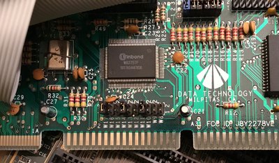

Hi, I need a manual or jumper settings for this VLB controller
It’s a Data Technology model # DTC2278D
There are several online but not the right one.
Mine has 2 IDE channels.

I have floppy drive and parallel port and serial ports working but the IDE ports are not working.
Any Ideas?
The motherboard I am using is a Gigabyte GA-486vs.
I already swapped out IDE cables and hard-drives.
The problem appears to be with the controller itself.

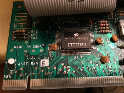

Reply 13 of 15, by PC Hoarder Patrol
Despite the backplate label saying the model is 2278D, I now see the pcb says 2278S/D (below the IDE port) which is a slightly different layout
https://web.archive.org/web/19990508184740/ht … 8/2278sd3.shtml
Did you look thru the FAQ I listed earlier, as it says
CMOS settings...disable IDE Block Mode and 32-Bit transfer options if enabled. Enabling these options in CMOS conflicts with the DTC drivers which turn on these options.

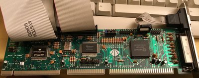

Reply 15 of 15, by Disruptor
I can give you my jumper setting for the DTC-2278D
W17 1-2, W16 1-2, W15 NC, W14 NC, W13 1-2, W12 NC, W11 NC, W10 1-2, W9 NC, W8 1-2
W7 no jumpers possible, W6 2-3, W5 1-2, W4 2-3, W3 1-2, W2 1-2, W1 2-3
