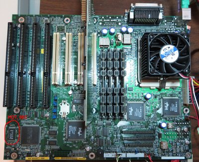

I have an Intel VS440FX motherboard that I cannot get to power up properly. The CPU fan spins fine, but the monitor stays blank. All three lights on the keyboard blink twice, which is usually occurs during a normal boot procedure. The power LED, which is connected to PWR LED on the motherboard, just blinks on and off. POST card shows all voltages OK. CLK, IRDY, and FRAME LEDs on the POST card remain illuminated. I did not spot any broken traces. I am using 256 MB of 60 ns FRM memory with parity, but I also tried 128 MB of 60 ns EDO, non-parity. For graphic cards, I've tried a VirgeDX and Matrox G200. I have tried three different power supplies.
I measured the VRM voltage to be 3.3 V, which is about what it should be for a Pentium Pro. I measured the following resistances with nothing plugged in:
12 V to GND = 3 K-ohms ---- [yellow cable]
5 V to GND = 61 ohms ---- [red cable]
3.3 V to GND = 10.4 K-ohms ---- [orange cable]
-12 V to GND = 2 M-ohms ---- [blue cable]
-5 V to GND = 0 ohms ---- [white cable]
I assume the motherboard is connecting the -5 V line to GND? Is 61 ohms between 5 V and GND OK?
The only glaring problem I noticed is that the EEPROM BIOS, Intel E28F002, gets abnormally hot, even after only 20 seconds of on-time. My IR gun shows its surface temperature at 60 C. My finger cannot remain on the chip for more than a second. No other IC's on the MB feel hot at all. I checked for metal shrapnel on the BIOSes pins, but found none. Is it possible that the previous owner ruined the EEPROM chip with a botched BIOS update attempt? And would this cause the BIOS to run hot like this?
I tried with and without the CMOS battery. I already tried resetting the CMOS clear jumper and putting the jumper back on normal operation.
Any other suitable ideas to test for?

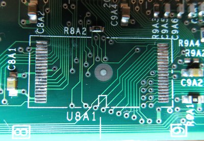

Reply 12 of 80, by feipoa
Alright. Let me feel around with some other components as well. I'll see if solder braid can remove the EEPROM, then I'll recheck the 5V-to-GND resistance. I think I also have some of that Quick Chip stuff from the 90's that I never used. Think it is necessary to salvage the EEPROM, or is solder braid sufficient for a two-sided TSOP-40?
Reply 13 of 80, by feipoa
I removed the EEPROM. I ultimately didn't use any wick or QuickChip, but just used the solder as if it was QuickChip. Demo video from someone else here: https://www.youtube.com/watch?v=nZGEtpECPQY
Now when I measure 5V to GND on the motherboard, I get 1.42 K-ohms. This supports the hypothesis that the EEPROM is the issue here. No other IC on the board is hot. The interesting thing is that the with the EEPROM removed, I measured 24 M-ohm between Vcc and GND on the EEPROM. So how do I get 61 ohms between 5 V and GND when the EEPROM is soldered onto the motherboard?
I'm left in the position of: a) find someone who can program an E28F002 EEPROM chip, or b) find a programmer which can program this chip.
Apparently the XGecu TL866II Plus or TL866CS will program this chip. The EEPROM chip from my MB is the 80 ns piece, or E28F002BCT80. I only see this being sold on eBay for $120 - https://www.ebay.ca/itm/E28F002BCT80/14210667 … P8AAOSwFV9XyuoS , while the 120 ns chip, that is -BCT120 is $5+$10 - https://www.ebay.ca/itm/312641061487 . Do you think there is any necessity on this board for the 80 ns EEPROM? Or does anyone know of a compatible EEPROM part number?

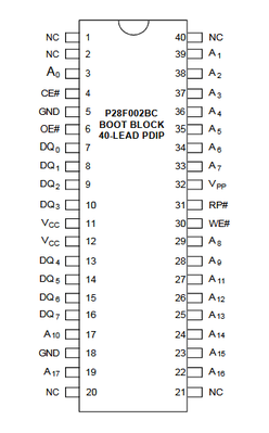

Reply 14 of 80, by SSTV2
Drop the idea of buying a programmer just to flash that chip, you can use a DIP40 to TSOP40 converter and use your regular programmer or in worst case scenario - hot-flash it in any MB that is compatible with it (GA-686BX might fit). You can also create your own adapter with just 2.54 headers and lacquered copper wires.

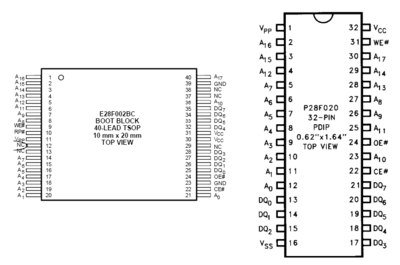

Reply 15 of 80, by feipoa
I don't think I have another board that is compatible with this EEPROM and my current programmer also doesn't support the P28F002. How then to use the Wellon VP-390 to program a P28F002 or E28F002?
Reply 16 of 80, by SSTV2
Now I see why that chip cause you problems. This flash chip has built in a boot-block protection mechanism, but outside of that, it's still just a regular flash chip. You can rewire it to a 28F020 pinout and your programmer should accept it, just connect Vpp to the pin on 28F002 that controls boot-block protection.
Reply 17 of 80, by feipoa
My programmer does have an option for the 2 Mbit Intel P28F020 EEPROM. Aside from NC's, the difference in pinouts between E28F002BC and P28F020 is that the E28F002 has an RP# input pin, while the P28F020 does not. The manual lists RP# as,
RESET/DEEP POWER-DOWN: Provides three-state control. Puts the device in deep power-down mode, locks, and unlocks the boot block from program/erase. When RP# is at logic high level (6.5V maximum), the boot block is locked and cannot be programmed or erased. When RP# = VHH (11.4V minimum ), the boot block is unlocked and can be programmed or erased. When RP# is at a logic low level the boot block is locked, the deep power-down mode is enabled and the WSM is reset—preventing any blocks from being programmed or erased. When RP# transitions from logic low to logic high, the flash memory enters the read array mode.

So I should connect the pin on the Wellon programmer which corresponds to Vpp for the P28F020 directly to RP#?
And I would need something like the top half of this TSOP to DIP adapter and run 32 male-to-male jumper wires to the Wellon?

Reply 18 of 80, by SSTV2
Yes, or just put a jumper wire directly on the chip/adapter across the two pins, RP# must be @ 12V~ for chip to unlock boot-block.

feipoa wrote:
The BVT unit has an extra WP# pin on it, which is N/C on the BCT unit. Should the BVT work? On the motherboard, this particular pin goes to GND via a 100-ohm SMD resistor.
If that pad connects to a pull-down resistor on MB, then manufacturer has already thought about making it compatible with flash ROMs that do have WP# pin. According to datasheet, WP# has the same function as RP#, it's there only to make it compatible with systems that can't supply 12V.
Reply 19 of 80, by feipoa
WP# pin has replaced a DU (Don’t Use) pin. Connect the WP# pin to control signal or to VCC or GND (in this case, a logic-level signal can be placed on DU pin). Refer to Tables 2 and 9 to see how the WP# pin works
OK, so for this motherboard, WP# is redundant and unused.
Unfortunately, I don't see the wiring diagram for this TSOP adapter, but presumably when adapters SN003 + SN001-2 are connected, the pinout is like that of P28F020? I don't really want to figure the pinout by hand touching these little SMD leads on the TSOP40.
