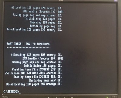

Reply 36 of 167, by Scali
maxtherabbit wrote:
EMS just doesn't work on this system outside of synthetic tests apparently.
Which brings me back to my earlier point of the possible limits of these synthetic tests.
Reply 37 of 167, by maxtherabbit
Scali wrote:
Sure, it's a good point. I just don't have the DOS ASM chops to write a better test

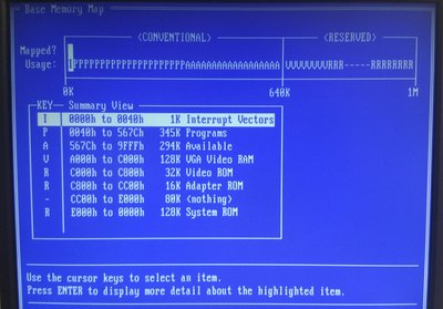

Here's the memory map without the EMM driver loaded, clearly showing nothing in the page frame area:
1.67 MiB
549 views
Here's the result of TESTEMS:
1.06 MiB
549 views

I would suggest one last try with Intel Above Board and setting the EMS Page Frame to CC00 instead of D000.
And, check to see if STACKS=0,0 an STACKS=9,256 in CONFIG.SYS will make any difference.
