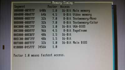

I may be onto something else though... if this PCCONFIG program is to be believed, even the 16-bit Above Board still only allows 8-bit access to its page frame. I've tried moving the page frame to D000, CC00, and C800 (while also relocating the SCSI ROM, when appropriate, with jumpers) but regardless of where the page frame is, it still shows up as only having 8-bit access.
bakemono could be 100% on target about DMA writes from the SCSI card only supporting 16-bit width and failing to write to a page frame with 8-bit access.
(BTW I did try waitstating the SCSI BIOS just now, no effect. Also tried the /L switch with smartdrv and it had no effect, it was already loading low)
(Also tried DMA 0 just now, no change - I think on a 16-bit system selecting DMA 0 is just the same as selecting DMA 4)
Had the Above Board installed and configured with the page frame at C800 in this screenshot (SCSI ROM @DC00)

Reply 52 of 167, by kjliew
Your last picture looks strange. The SCSI BIOS didn't show up as ROM but the EMS Page Frame of 96KB????
Somehow, the Intel Above Board mapped memory overlapped with your SCSI BIOS. This is very bad. Any diag software scanners should easily detect the ROM.
Reply 53 of 167, by maxtherabbit
No it didn't overlap. That particular informational display only distinguishes regions by timing factor. The description field is unreliable. Any other diag (MSD, Checkit, etc.) showed a distinct 64kB page frame between C800-D7FF and the SCSI ROM from DC00-DFFF
