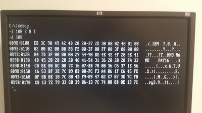

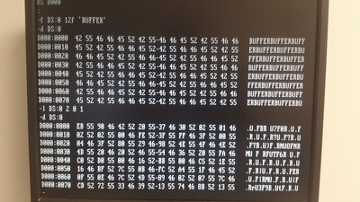

***IT'S THE BITS BOIS***
Here's the first sector of my boot partition:
1.53 MiB
919 views
Now here's me filling the beginning of the first EMS page with a pattern, then loading that same sector from disk on top:
1.78 MiB
919 views
Notice how only the even columns got updated??
thanks to kjliew for the tips on using DEBUG - I had no idea it was so easy to work with EMS handles in DEBUG!
thanks to bakemono for the theory which proved true!
NOTE: this test was performed with the Lo-Tech, I will retest with the Above Board, but I suspect that it does in fact only allow 8-bit access to its page frame and the results will be the same
EDIT: confirmed same result with the Above Board
