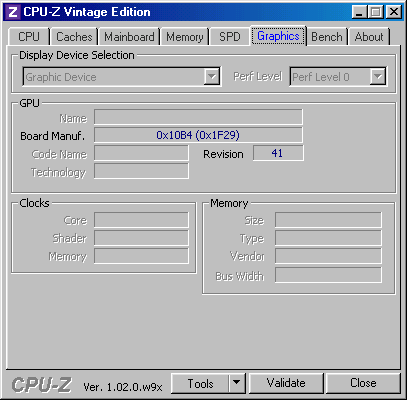

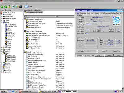

Reply 358 of 440, by Takedasun
STB Nitro DVD 4MB AGP.
9.21 KiB
2095 views
61.25 KiB
2095 views
    mpact2.zip
    2.53 KiB
    57 downloads

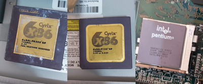

Reply 359 of 440, by SteveC
Here's a few. AST Bravo MS Motherboard (HX chipset) with an Intel P133 (@133MHz), a Cyrix 6x86L P200+ (@133MHz - I can't do 75MHz bus on this board!) and a Cyrix 6x86 P150+ (@120MHz, and a million bent pins, and this got HOT!).
The board has 16Mb (2x8MB FPM SIMMS), no L2 cache (no COAST module) and an ATI Mach64 graphics chipset.
