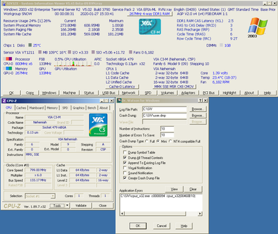

Reply 181 of 440, by red-ray
The latest CPUZ_x32 crashes, but CPUZ_95 runs and I suspect you may wish to use the C3-M logo
file.php?id=76000
    51.4 KiB
    3784 views
    Screen shot showing cpuz_x32 crashed
    RVN.zip
    14.98 KiB
    82 downloads
    Crash dump files and report

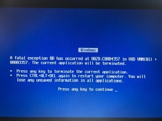

Reply 183 of 440, by Slashzero
I’m trying to run the Win95 version, but it caused a BSOD when I ran it. Attaching image so you can see the error.
17.22 KiB
3737 views
I reset the laptop, and tried again. Made it to 22%, and the system froze.
Had do do a hard reset. Control-Alt-Delete did not work.
Tried a third time. It is consistently locking up my laptop at 22% (Monitoring).
25.01 KiB
3738 views

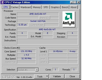

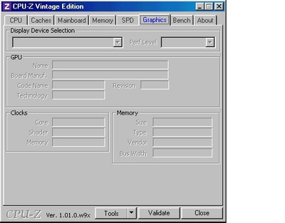

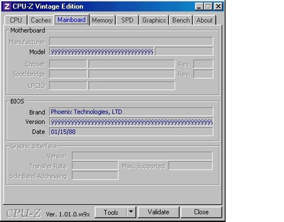

Reply 186 of 440, by CoffeeOne
Last but not least, I am going to the cpu-z with the antique computer (Micronics ASIC EISA mainboard, 133MHz Kingston Turbo chip, 64MB 30 pin SIMM RAM, only EISA slots) as well.
On Windows 98 SE I have to use the Vintage edition 1.01.
So I started it and ***boom*** blue screen, but fortunately windows kept running, no reboot necessary.
But I very quickly found out, how I could run it:
I changed in the ini file "SPD" to 0 and it worked.
The cpu is detected well, the mainboard (and so the 256kB L2 cache) and the graphics card are not detected.
    39.21 KiB
    3711 views
    48.03 KiB
    3711 views
    30.48 KiB
    3711 views
Reply 187 of 440, by Slashzero
red-ray wrote on 2020-02-12, 08:45:
Slashzero wrote on 2020-02-12, 03:03:
Try editing cpuz.ini and changing Sensor=1 to Sensor=0
So, the zip file didn’t have an ini file to start from. It just had the single exe. I suppose I could create an ini file and put the single setting in it, and hope it reads it.

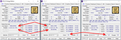

Reply 189 of 440, by red-ray
The CPUZ Vintage Edition seems to have issues that CPUZ_x32 does not so I suspect some bugs crept in, further both the 32-bit builds report the incorrect number of cores even though CPUID 0000000B correctly reports 18 cores to 32-bit programs.
file.php?id=76852
    60.42 KiB
    3685 views
    Compararison
Reply 190 of 440, by Slashzero
red-ray wrote on 2020-02-13, 09:42:
The CPUZ Vintage Edition seems to have issues that CPUZ_x32 does not so I suspect some bugs crept in, further both the 32-bit bu […]
file.php?id=76852
Locks up in the same spot. 😒

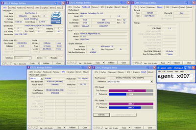

Reply 195 of 440, by CuPid
agent_x007 wrote on 2020-02-23, 22:28:
Any chance of making FSB visible together with RDRAM clock speed ?
yes, I check and let you know.
