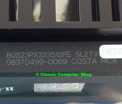

Reply 15 of 27, by SpectriaForce
BetaC wrote:
SpectriaForce wrote:
meljor wrote:
There are actually PII 350 & 400 specimens that do have an unlocked multiplier, you need to have one from before week 30 1998 if I remember correctly (does anyone has some more information about specific week number and stepping?)
Besides the Pentium II Deschutes does not need active cooling if it has a decent heatsink (many OEM's didn't attach a fan either). A case fan for some airflow won't hurt though.
Is there a guide for how to read the date codes on the processors?
Yes, here's an example:
208.19 KiB
314 views
The first code is the CPU model (Intel S-spec = SL2TV)
The second code tells you something about the production country and date manufactured. The first number = 0 = Costa Rica, the second number = 8 = 1998 and the third and fourth numbers = 37 = week 37. Because the PII 350 & 400 were initially very expensive, you'll have a hard time finding a pre week 30 specimen, but they do exist.
That's all I know, but I know that some experts over here can you tell you more about the second code and unlocked multiplier stepping codes. The Pentium II Klamath series are always unlocked (can be under- or overclocked by adjusting FSB and multiplier), as well as the Celeron 300A (possibly more Celerons in SEPP cartridge, but I'm not sure).

Reply 17 of 27, by BetaC
Yes, here's an example: […]
Then it looks like I have one of those rare ones, since my third and fourth numbers are 19.

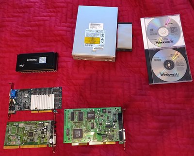

Reply 19 of 27, by BetaC
Because of me managing to grab a Voodoo 3 3000 last night, I decided to pull the trigger on grabbing a motherboard. I've decided to go with an Asus P2-99. I managed to find a tested one that already had 256MB put in, and an extra P3 for relatively cheap. Below are the parts I already have.
1.44 MiB
276 views
As always, my theoretically unlocked Pentium II-350, Voodoo 3, Yamaha (Audician?) OPL3 card, the AWE64 that was just sitting on a shelf at work, a working Creative CD5230E, and copies of both versions of Windows 98.Which version would be best for this build, FE or SE?
