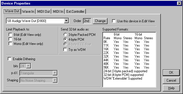

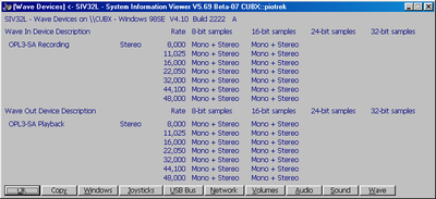

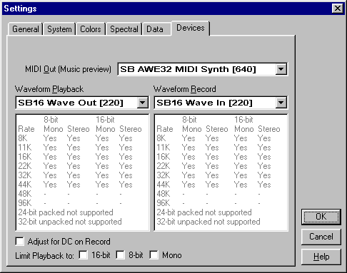

Reply 1000 of 1037, by GL1zdA
I will test it on the YMF719 during the weekend, but on my other system (Intel Advanced/EV motherboard with an integrated ViBRA) it shows nothing. A possibly important difference, it's an 95 OSR2 system.
EDIT: the "Wave" version of the previous beta reports something.
As for the enumerations etc. I think the "standard" frequencies (11, 22 and 44.1 kHz) are standard as far Windows Sound System 1.0 is concerned. I've looked through MSDN library from the 90s, and they will mention the other frequencies (8, 16, 32 kHz) in other articles, they are even recommended for hardware manufacturers to support in the PC 96 or PC 97 specifications (8 kHz was important for speach, 32 kHz AFAIK is DAT, can't remember what they said about 16 kHz). But apparently these were not important enough to add them to the "standard" frequencies.
    6.3 KiB
    1859 views
    SIV V5.69 Beta-07 Wave on Advanced/EV with ViBRA
    6.79 KiB
    1859 views
    Cool Edit 2000 1.1 on Advanced/EV with ViBRA
    5.23 KiB
    1859 views
    SIV V5.69 Beta-07 on Advanced/EV with ViBRA

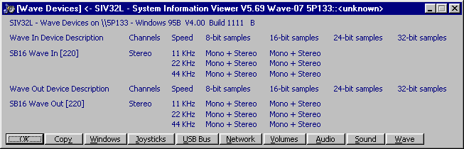

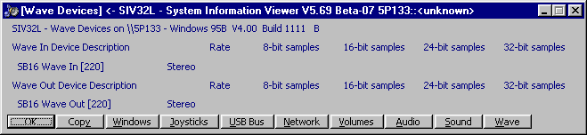

Reply 1001 of 1037, by red-ray
GL1zdA wrote on 2023-03-10, 15:07:
Thank you for checking, I need to check what happening on a W95 system here, but none of my W95 system have sound. My guess is that waveInOpen( WAVE_FORMAT_QUERY ) + waveOutOpen( WAVE_FORMAT_QUERY ) are different on W95.
The Wave-07 test version is reporting the WAVEINCAPS->dwFormats or WAVEOUTCAPS->dwFormats which I removed as they are already on [Audio Devices], let's see what happens with the YMF719 and take it from there.
Update: When waveInOpen() or waveOutOpen() fail MMRESULT should be WAVERR_BADFORMAT and I wonder if it's some other error on Windows 95. Does the attached SIV32L 5.69 Test-08 test SIV report any MMRESULTs please?

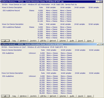

Reply 1003 of 1037, by red-ray
GL1zdA wrote on 2023-03-10, 21:21:
Here's a screenshot for the YMF719 - looks as expected. […]
file.php?id=159479
As for the 95 machine, I had only a brief moment for testing today, I will return to that one in April (had to split my collection between 3 places, so that my family doesn't kill me).
Thank you, this is what I was expecting would be reported and is what I get on my Windows 2000 Digital Alpha AXP 21164A (EV56) system.
OK, maybe another member will try SIV32L 5.69 Test-08 on a W95B system with sound.
file.php?id=159484
I felt I should check the panel worked on NT 4.00 and was surprised that Windows 2000 has more the NT 4.0. I wonder if it will work on NT 3.51.
    23.33 KiB
    1822 views

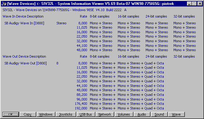

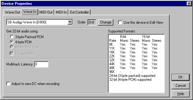

Reply 1004 of 1037, by GL1zdA
Here's another report for 98 SE, this time with Audigy 2 ZS. Looks good, there's just not enough space to list all "modes" for 8-bit samples.
    7.97 KiB
    1807 views

Reply 1005 of 1037, by red-ray
GL1zdA wrote on 2023-03-14, 20:45:
There's a problem with identifying a GeForce 5900 in this computer.
Thank you for the report and if you hover over the Mono + Stereo + there should be a tooltip that shows the full text, is there? I could remove/increase the width limit, but then the panel might be too wide for small screens.
file.php?id=159832
SIV says 5900, what do you feel is wrong? SIV would do better on Windows NT 3.51 and later.

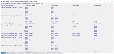

Reply 1007 of 1037, by red-ray
If I hadn't been lazy I would have made the panel width resizable.
file.php?id=159841
red-ray wrote on 2019-08-22, 10:17:
Systems and GPUs I would like to test on
  1. SIV is designed for Windows NT so if you have both Windows NT/XP and 9X use the NT/XP system as more will be reported. Chances are that if something is zero or absent on 9x/Me the correct value will be reported on NT 3.51 and later.
GL1zdA wrote on 2023-03-14, 22:01:
I miss GPU/MEM clocks. It's the only feature I care about for graphics cards. I assume it's doable.
So not an issue with identifying it as a 5900. All things are doable if you have infinite time and an infinite budget! As I clearly specified "SIV is designed for Windows NT ".
red-ray wrote on 2023-03-14, 21:37:
SIV would do better should report the clocks on Windows NT 3.51 and later.
    45.67 KiB
    1783 views
    After dragging it wider
