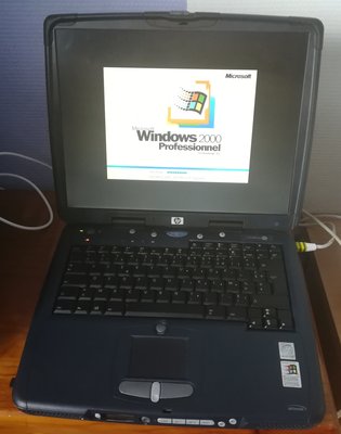

Okay so I installed Win2k on the Omnibook, thankfully I've somehow found the drivers for it, right now it's still installing the drivers as I'm posting this message.

Reply 184 of 1037, by Vynix
It's going fine so far (I had to wipe the hard drive, split it in two ~10GB partitions, reinstall W98 and finally install Win2k).
Right now it's still busy installing the drivers, it has rebooted as I'm writing this.

Reply 185 of 1037, by Vynix
Looks like it's hanging on section 221 (CPU TIMER) 😐
Edit: yup even with CPU-TIMER unticked SIV froze entirely then the whole system hardlocked, so I had to unplug the laptop to turn it off

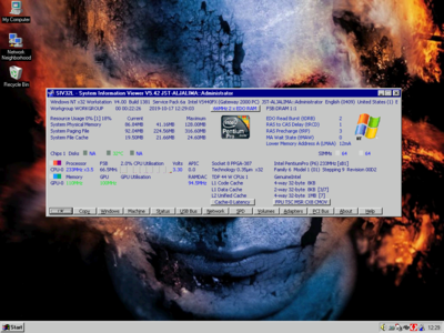

Sorry it took me this long! Seems to run fine... in that it doesn't crash, at least. The info all seems to check out the more I look at it, maybe if I had done this earlier I'd have actually been able to help with something. Banshee clocks are reported fine.
SIV_JST-ALJALIMA.txt
441.76 KiB
62 downloads
SIV_JST-ALJALIMA.zip
43.03 KiB
43 downloads
This is the .DMI file it made. Not sure how much use this is to you.
Thank you for checking out SIV and posting the save files, it's good to get a post when there were no strange effects 😀 I prefer to have the .DMI as SIV runs better in test mode when it's there, but these days I can manage better than I used to be able to without it as I added code to read the [machine] section from the save file and internally re-create the data it contains that SIV needs to run well in test mode.
I was pleased to see SIV report the 3dfx Voodoo Banshee as this is the first time I have seen it do this. Looking at Menu->Machine->GPU Info there is 16MB which is what Windows reports as memory size as and 8MB which is what SIV read from the card. Clearly they both can't be correct and I suspect the GPU really has 16MB, does it? Have you tried HWiNFO on the system, if so what does it report as the GPU memory size and are the clocks the same?
Edit: I just spotted such as Menu->Help->SIV Lookup did not report the image type and versions. This is down to DBGHELP.dll not being there and if you put the attached into C:\WINNT\system32 then SIV should do better. I suspect you must have put PSAPI.dll V5.00.2134.1 there, did you?

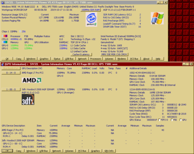

Reply 198 of 1037, by xjas
red-ray wrote:
Thank you for all the information and sorry for my delay in replying as I have been busy with the SIV 5.42 release today. […]
xjas wrote:
If I set the Voodoo as primary, I can't enable dual-head mode & span the desktop, because I get an error that the frame buffer address space conflicts between the two cards & can't be remapped. With the Rage as primary it works fine.
I half suspected the Rage needed to be the primary for it to work. I have pondered the I/O Access and adjusted SIV, please will you try the attached SIV32L 5.43 Rage-00 with the Rage as the primary and see what get's reported as the Voodoo 3 clocks.
Just drop the new files over the previous ones as the kit only includes the changed files.
After mentioning the I/O Access effect to Martin I suspect HWiNFO may also fail to report the Voodoo 3 clocks when the Rage in primary, does it? If so I suspect it will if you first run SIV and SIV enables I/O Access as it should.
Edit: I checked on my Windows 2003 R2 system with a Voodoo 3, my suspicions about HWiNFO were correct and it reported 7.1 MHz clocks 'till I ran SIV which enabled I/O Access.
Sorry, it took a little longer to get back to this due to some driver issues on the machine (& me not having time to fix them - long story.) Voodoo clocks are being reported correctly in all three configurations of primary/secondary. 😀 Please see attached. (Also I bumped up the resolution to 1152x864 and the RAMDAC speed changed on the Voodoo card, as it should.)
It's still showing "0MB 64-bit SDRAM" for the Rage, but looking pretty good otherwise.

red-ray wrote:
For ATI then yes, it would spaghetti code, but I guess I could cleanly use the ATI Rage logo for Rage GPUs as AFAIK there are no AMD Rage GPUs, do you know of any?
Edit: If you use the SIV-5.43-Savege-00.zip I just posted you should get ATI logos for Rage GPUs.
Nice! Yeah, it's safe to say all Rage-series GPUs are ATI products. Even the relatively recent ES1000 server chip (which is some descendant of the Rage line) is still branded ATI.

Thank you for your excellent testing, I expected it to work as I tested it on my Voodoo 3 2000, but what I could not check is that things would be OK when the VBIOS had not set I/O Enabled in the first place as I can't get my system to post with a PCI primary GPU.
I just need to fix the Voodoo Banshee memory size reading from the chip and then plan to release 5.43 Beta-00 which will include this I/O Access fix. I was expecting I would need to release Beta-00 to support the next Windows 10 20H1 insider build but M$ seem to be running late.
The 0MB is down to SIV not having a VXD for Windows 9x and on Windows NT/2K/XP it should get the size correct.
