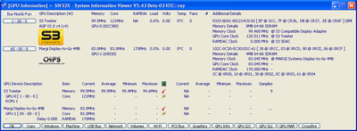

I tried SIV on a Savage/MX and the clocks were wrong so I have adjusted the code. Please will you try the attached SIV32L 5.43 MCLK-03 on your HP OmniBook for me? Put the new SIV32L in the same folder as you have Beta-02.
I am mainly interested in what Menu->Machine->GPU Info reports.

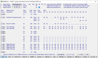

Maybe the missing DIMM SPD is down to an SMBus multiplexor, Martin does not know if there is one so I doubt HWiNFO will report it, but I don't know if AIDA64 will. If it does I will find out how to drive it. I used to have the same issue on my Compaq W6000 and one day it irritated me once too often so I toggled the GPIOs 😅, after a couple of system powerdowns I found it was controlled by GPIO 18 and now SIV reports the RIMM SPD 😁. Notice how there are 2 SMBuses with the RIMMs being on the second SMBus.

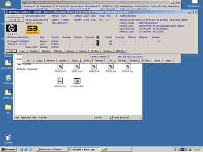

Anyways, here is what you requested, both TXT log and raw dump files are included.

Reply 246 of 1037, by red-ray
Vynix wrote:
Anyways, here is what you requested.
Thank you and sorry for the delay in replying, you having notebooks reminded me I have a Margi Display-to-go 4MB and I have been getting SIV to correctly report it's clocks.
file.php?id=70767
The test SIV worked as I hoped and the S3 Savage/IX clocks look good to me and to my surprise one set of DIMM SPD was reported. This makes me wonder if it's just a bad connection, have you tried reseating and/or interposing the DIMMs?
I am pleased you sorted out your W2K issues and once you told me it was a HP OmniBook XE3 GC I felt SIV should display this rather than HP OmniBook PC, so Beta-03 will.

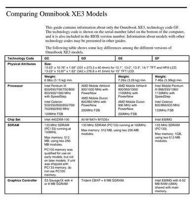

I've also seen that there was other models of Omnibook XE3s, of which I can't find anything about them, I'll list them here:
  • Omnibook Xe3 "GC" (the one I have, seems to be the most common version, Intel Pentium 3/Celeron, S3 SavageIX/MV)
  • Omnibook Xe3 "GD" (AMD Duron/Athlon? Frequency unknown, Trident CBXP Graphics w/ 8mb VRAM)*
  • Omnibook Xe3 "GE" (AMD K7 Duron or Athlon)*
  • Omnibook Xe3 "GF" (Intel Pentium 3/Celeron, Intel 830MG graphics (??)
About the GD and the GE, I could not find anything on them, the only reference I could find is in some kind of manual: https://www.manualslib.com/manual/71748/Hp-Hp … e3.html?page=18
But I also found this chart (from some HP documentation) showing the different Omnibook Xe3s variations, it's sure handy given that the XE3 is a obscure system!

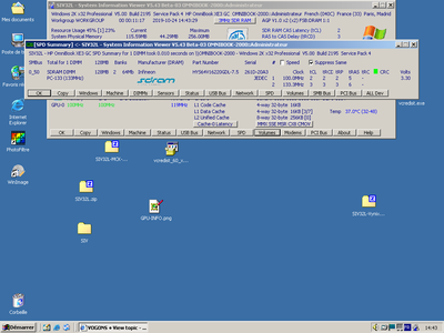

So here we go, the DIMMs are both reported to be made by Infineon (which would be correct, as the chips on them were all Infineon-branded).

Thank you for checking out Beta-03 and I am pleased to see that SIV now reports HP OmniBook XE3 GC.
It's strange that they are both the same but only one of them reports SPD, I wonder why 😕

Yeah it's a bit strange, there are indeed two DIMMs, it ain't a big deal since I intended to swap them for 256mB DIMMs anyways.
EDIT: Even AIDA32 (version 3.93 from 2004) reports only one.

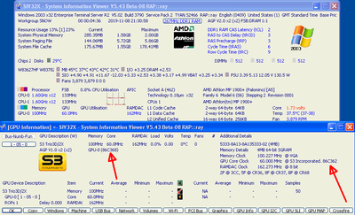

I have just uploaded SIV 5.43 Beta-08 which has support for the S3 Trio3D/2X. Below you can see it reports my S3 Trio3D/2X (86C368), but the S3 driver seems to think it's a 86C362 😕.
If you have a S3 Trio3D/2X (86C362) please will you post a similar screen shot so I can check SIV detects it as a 86C362 and correctly reports the clocks.

How did you get the reading for the Trio3D/2X? To my knowledge, cards with 100mhz memory have a higher clocked chip. It seems to me that models with 86x362 are clocked lower than 86x368 but I am still playing with these cards. Does SIV 5.43 Beta-08 support Win98SE? I have a lot of these cards and I can send results over time

  1. SIV reads the S3 PLL registers and calculates the clock speeds.
  2. I have only tested on the single S3 Trio3D/2X that I have which has an 86x368 that the Windows 2003 default driver incorrectly reports as 86x362.
  3. Yes, SIV32L should report the S3 Trio3D/2X clocks on W98 and later.
