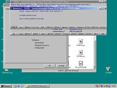

Hi
I've since managed to fix the 430VX system, it turned out that it wasn't the VRMs but rather there was a jumper that raised the Vcore voltage by 2.5% and apparently the older P133 could handle it fine, wheras the P233MMX couldn't without becoming unstable! After closing that jumper now it's all fixed.
I've also patched the BIOS of my board to fix the BIOS' 32gb bug (as in, the BIOS would literally crash when detecting hard drives larger than 32gb), I don't have any IDE HDDs on hand to test but we'll see if it works.
Also for some reason I was unable to get the monitor information, SIV had returned a "Error 2 - the specified file is missing" (since my system's locale is set to French) but otherwise I didn't have any bug:

Vynix wrote on 2021-04-18, 13:48:
Thank you for the report and I am happy to hear you resolved the stability issue.
I suspect the Error 2 is down to HKLM\System\CurrentControlSet\Enum\Display not existing on Windows 9x systems, please can you check if it's present? If it is please post the registry export otherwise I will adjust SIV not to offer Menu->System->Monitors for Windows 9x systems.
Update: I searched my Windows Me system registry for EDID, found it and managed to make Menu->System->Monitors work. How does the attached SIV32L 5.58 EDID-00 test SIV do on your system please?

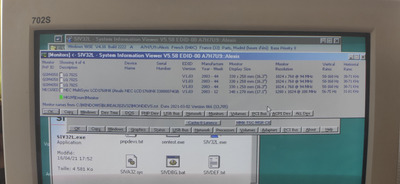

Reply 749 of 1037, by Vynix
I'll be sure to do that tomorrow, the 430VX system isn't at my place (at the moment it's stored at my grandparents' house).
I can't rember if this registry key was present on the 430VX... But I'll check again just to be sure.
Reply 750 of 1037, by red-ray
Vynix wrote on 2021-04-18, 17:28:
I can't remember if this registry key was present on the 430VX... But I'll check again just to be sure.
OK, I guess you did not notice I updated the post, it looks like on Windows 9x HKLM\Enum\Monitor needs to be used so I updated SIV32L 5.58 EDID-00 to use this
Reply 751 of 1037, by Vynix
Ah right I saw your updated post, I'll try it tomorrow on the 430VX.
Reply 752 of 1037, by Vynix
Looks like it's working now
Reply 753 of 1037, by red-ray
Vynix wrote on 2021-04-19, 12:31:
Thank you and yes. I am not sure what to do about the duplicates which I suspect are associated with different GPU instances
Reply 754 of 1037, by Vynix
Oh the duplicates are due to the different monitors that I used with this system, it's nothing to worry about. I never changed the GPU in this system, it always was a S3 Trio64V2/DX, although I did put it in different slots, so that's possibly why multiple monitors show up.
