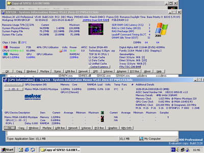

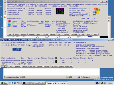

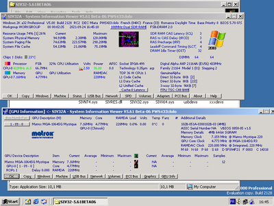

red-ray wrote on 2021-09-19, 13:00:
lolo799 wrote on 2021-09-19, 11:35:
I also have a 1164 Mystique that came with my BeBox, i'll put it in the Alpha to check with both old and new PCIDEVS.
OK, I would be inclined to install both in Alpha.
I have found the issue with the divide by zero crash and should have fixed it in the attached SIV32A V5.61 Zero-07 test SIV.
Tried Beta06 with the Mystique 220 and Zero07 with both old and new Mystique.

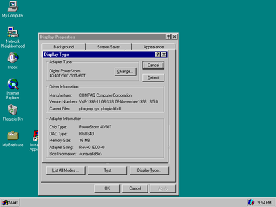

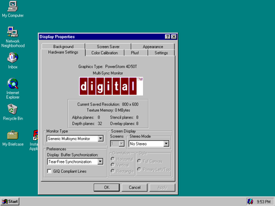

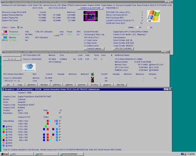

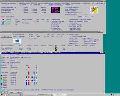

Reply 804 of 1037, by lolo799
Managed to install NT4 on the PWS433, weirdly enough using AlphaBios to create partitions and the install Windows NT to select a system partition never worked but using arcinst.exe to create a system partition then soft rebooting the machine did...
Tried both Beta06 and Zero07 with the Powerstorm graphic card drivers installed.

lolo799 wrote on 2021-10-03, 14:18:
Thank you for checking out SIV on NT4. In terms of reporting the Digital PowerStorm 4D50T it seems quite strange as it's made up of two PCI devices and all that SIV reported is the Cirrus CL-GD5430 memory clock.
I noticed that SIV did not report the Cirrus Chip ID so I adjusted the attached SIV32A 5.61 Chip-07 to add this and also added code to report the RGB640 RAMDAC speed which AFAIK is 230MHz.
In terms of testing just use SIV32A 5.61 Chip-07 as it's a superset of both 5.61 Beta-06 + Zero-07.

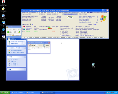

Ran SIV32X on a Nexterm RT-500 thin client
http://web.archive.org/web/20060501041304/htt … product/rt.html
109.65 KiB
1214 views
Reply 808 of 1037, by red-ray
lolo799 wrote on 2021-10-20, 20:59:
Thank you for checking SIV out on the Geode and the link to the Nexterm RT-500 details. To me SIV looks to have done OK, did you spot anything that needs adjusting?
SIV was unable to find any SMBIOS/DMI information and searching through the .DMI file I could not even find Nexterm or RT-500 so can't think of a sensible way to get SIV to report this.
The 東京 (標準時) made me wonder if you speak Japanese and if so I would be interested to hear how good/bad the SIV Japanese is, do Menu->Edit->Language->Japanese to switch.
Reply 809 of 1037, by lolo799
red-ray wrote on 2021-10-20, 23:05:
Thank you for checking SIV out on the Geode and the link to the Nexterm RT-500 details. To me SIV looks to have done OK, did yo […]
The board was made by PiNON, named RT500 in the bios, and sold by Nexterm as a thinclient with the OS and various software.
It comes with a Japanese version of Windows XP embedded by default, I don't speak Japanese, sorry.
Reply 810 of 1037, by red-ray
lolo799 wrote on 2021-10-21, 08:15:
OK, as I like to dot the i's and cross the t's I adjusted the attached SIV32X 5.61 Test-10 so it should report PiNON RT500, does it please?
From the Romance Daylight Time on the DEC Miata PWS433 I assumed you were in Europe, but felt it worth asking about Japanese as I assumed the XP Embedded could have the locale switched, can it?
Reply 811 of 1037, by lolo799
red-ray wrote on 2021-10-21, 16:18:
I'll try the Test-10 and report.
I'm in France, haven't yet tried changing the locale settings in XP Embedded, having to modify the Admin password just to run SIV32X took much of the time I spent using it...

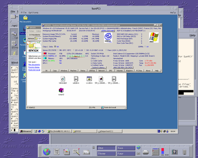

And another report, Windows 2000 running on a SunPCI II card in a Sunblade 100 workstation.
https://en.m.wikipedia.org/wiki/SunPCi
50.79 KiB
1169 views
Reply 813 of 1037, by red-ray
lolo799 wrote on 2021-10-21, 16:26:
Thank you, this is the second report I have had from one of these, the previous one was on 2003-05-23 @ 15:54:54 , these days SIV reports rather more, the old report is 53 KB rather than 523 KB !
