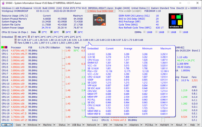

Reply 867 of 1037, by mastergamma12
red-ray wrote on 2022-02-19, 21:29:
Thank you and I just checked, the panel is 1103 pixels high and your screen is only 1080 when I had assumed it was taller. […]
mastergamma12 wrote on 2022-02-19, 18:29:
Looks good to me. Also the line thing didn't seem to work.
Looking at [ Status ] I spotted some issues which were down to typos which I should have fixed in the attached SIV64X 5.63 Tidy-07 test SIV, please may I have new save files generated after SIV has been running for at least 10 minutes.
Now that SIV supports the EVGA X570 FTW it would be best to just look at the [ Status ] panel.
Here

Reply 868 of 1037, by red-ray
mastergamma12 wrote on 2022-02-19, 22:08:
Here
Thank you, all the names and values look good to me. Did you check the fan names with fans connected to the unused headers?
I noticed the EV 3.29 3.27 1.10 1.36 5.01 1.80 12.16 3.29 1.81 0.91 1.21 0.89 0.95 1.20 0.69 2.53 0.96 0.97 3.32 1.73 0.69 0.68 was truncated and am wondering if it should be on a new line as below, what do you think?
file.php?id=130890

Reply 869 of 1037, by mastergamma12
red-ray wrote on 2022-02-20, 09:43:
Thank you, all the names and values look good to me. Did you check the fan names with fans connected to the unused headers? […]
Here
file.php?id=130890
Fans were good, as for that, It's up to you

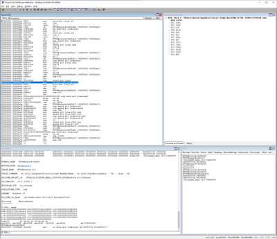

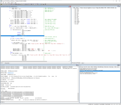

Reply 872 of 1037, by red-ray
mastergamma12 wrote on 2022-03-22, 18:22:
So I've been getting a weird issue with SIV where if I open it using Winrar
Thank you for the report, but you should specify which version of SIV this is rather than making me guess. This time I tried SIV 5.64 Beta-00 and the WINDBG played ball.
Does this only ever happen when you run SIV64X from WINRAR and does it always happen ? Is WINRAR a 64-bit program?
Looking at the crash it looks like the issue is with RTSSHooks64 rather than SIV64X as the call stack of the crashing thread is as attached.
Looking at other SIV threads all is OK, one example is the sensor thread which is reading the SPD.
I just ran SIV64X V5.64 Beta-00 directly from SIV64X.zip using WINZIP 19.0 (11294) - 64-bit and it started and runs as it should.
SIV is none to keen on being run directly from .ZIP files and I suggest you don't do this, it usually tells you this.

Reply 873 of 1037, by mastergamma12
red-ray wrote on 2022-03-22, 20:00:
Thank you for the report, but you should specify which version of SIV this is rather than making me guess. This time I tried SI […]
[SIV Location] <- SIV64X - System Information Viewer V5.64 Beta-00 RED::ray
SIV64X - running on \\RED - Windows 10 x64 Enterprise V10.00 Build 19044 21H2
SIV64X.exe is currently running from C:\Users\ray\AppData\Local\Temp\wze889\
and SIV64X.exe was unable to find the SIVX64.sys driver, extract the files from siv_beta.zip into
C:\Program Files\SIV\ or similar and run SIV64X.exe from there.
[ http://rh-software.com/Using SIV to Control AIO Devices.pdf ]
[ OK ] [ Copy] [SIVDriver][SIV Driver][SIVs Active][SIV Location]
Yeah it only happens when I launch it from Winrar and it is a 64 bit program. I took your advice and installed it in my program files folder. Nice to know that Rivatuner caused it.
Yep, it's definitely Rivatuner, I disabled it on my X570 FTW rig and no more crashes, also I updated MSI Afterburner (which includes Rivatuner) on my HTPC with a Z370 FTW and 9900kf and same thing happens on there now.
At least I know my computer isn't buggy. 😁

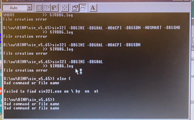

Reply 876 of 1037, by GL1zdA
Is SIVDBG.bat compatible with Windows 9x? SIV hangs on my PC (and I have similar results with HWiNFO, AIDA64 on the other hand works) and I assume SIVDBG.bat creates a log file that could help find the problem.
    195.13 KiB
    1065 views
Reply 877 of 1037, by red-ray
GL1zdA wrote on 2022-08-05, 20:50:
Thank you for the report and given the screen shot it looks like SIVDBG.bat has issues on W9x as it uses constructs that are not supported.
If from a command window you type SIV32L -DBGINI -DBGPCI this should generate SIV_DBGOUT.log, assuming it does then post it and I should be able to tell what SIV was doing when the system locked up.
Has HWiNFO been fixed to stop the lockup?
Reply 878 of 1037, by GL1zdA
red-ray wrote on 2022-08-05, 21:41:
Thank you for the report and given the screen shot it looks like SIVDBG.bat has issues on W9x as it uses constructs that are not […]
I'm attaching the .log file. No, HWiNFO32 still bombs during PCI detection (in the exact same way as SIV - everything freezes, only cold reboot helps). The DOS version of HWiNFO on the other hand works.
    SIV_DBGOUT.log
    3.88 KiB
    56 downloads
Reply 879 of 1037, by red-ray
GL1zdA wrote on 2022-08-05, 22:11:
Thank you for checking out SIV and attaching SIV_DBGOUT.log. The system looks to be locking up when SIV is trying to read a none existent PCI device, what's strange is that it successfully tried to read 13 and the 14th triggered the issue. Doing the same on my 440BX system (Gigabyte GA-6BXD) all was OK. I don't recall ever seeing this before and feel there must be something marginal with the hardware. Have you checked the PSU voltages and are all the capacitors OK?
That said SIV was trying to find the GPU when the lockup happened and while checking it on my 440BX system noticed the code was not ideal. I have adjusted this in the attached SIV32L V5.66 Hope-04 test SIV, please will you try it and post a new SIV_DBGOUT.log (delete the old one).
This time type SIV32L -DBGINI -DBGPCI -DBGGPU and it the lockup still happens try SIV32L -DBGINI -DBGPCI -DBGGPU -NOGPUS.
If SIV now starts do Menu->File->Save Local then post the save file so I can check there are no other issues.
Do you have any of WXP, W2K or NT4 on the system? If so it would be interesting to know if the lockup happens with those systems as SIV will use HalGetBasDataByOffset() to read the PCI config space rather than using INT 0x1A.
