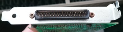

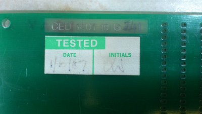

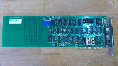

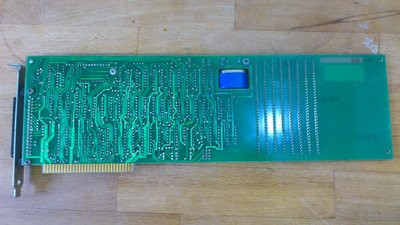

Hi all, does anyone know what this card is or what it does?
The only markings are "CED 1401 10 G 241" (the latter three digits hand-written) and "IGAV" which is presumably the PCB (not card) manufacturer.
It has a 3.6 V embedded battery which is not removable
There is a male DC-37 connector on the I/O bracket.
Chips include D8253C-5 Programmable Interval Timer.
(I don't know why the expanded images are upside down or rotated.)

Reply 1 of 5, by Caluser2000
Show us the connector.
Reply 4 of 5, by HanJammer
This is 8-bit data aquisition device or (more likely) interface for connecting one to the PC - usually used for specific purposes in industry or science. I like how it has provisions for installing your own THT components.
Edit: Pretty likely it's internal card interface for one of those: https://www.labmerchant.com/cambridge-electro … quisition-unit/ (CED 1401 line of products dates back to 1983, I work for a thermonuclear research institute and I've seen devices like this in use).

Reply 5 of 5, by Errius
Good find, it's got the same DC-37 connector on it. That must be what it's for.
