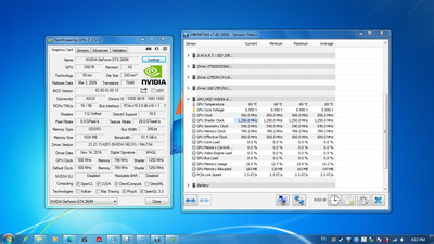

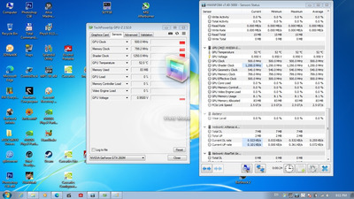

Reply 651 of 783, by vorob
Hi Mumak! Maybe there is a chance you can help me, please. I’ve got a 2009 laptop with GeForce 260M, my problem is that none of known apps can read gpu load. I tried hwinfo, gpu-z, msi afterburner. All of them report zero load. I tried different drivers from 2009-2016. No luck. I’m on windows 7 x64. Don’t have access to similar machine to compare. But I’ve got older laptops and all report gpu load correctly. Can’t believe ASUS blocked this feature.
The attachment HWiNFO64.zip is no longer available
The attachment zero.jpg is no longer available
Reply 652 of 783, by Mumak
vorob wrote on 2023-03-19, 18:09:
Hi Murmak! Maybe there is a chance you can help me, please. I’ve got a 2009 laptop with GeForce 260M, my problem is that none of known apps can read gpu load. I tried hwinfo, gpu-z, msi afterburner. All of them report zero load. I tried different drivers from 2009-2016. No luck. I’m on windows 7 x64. Don’t have access to similar machine to compare. But I’ve got older laptops and all report gpu load correctly. Can’t believe ASUS blocked this feature.
HWiNFO64.zip
We completely rely on drivers here, more precisely NVAPI and don't have any alternatives in this case. And that reports 0%.. So the problem can be only fixed in drivers.
Reply 653 of 783, by vorob
Thanks Mumak! I've also checked other machines with 260 on YouTube, and they also don't report gpu load. So, my sample is not broken, just some weird way chosen by ASUS.
I was also studying another issue, and this again brought me here. You see, the clock of my GPU is 500mhz on core and 800mhz on memory and gpu-z reads it properly, but msi afterburner gives me 540 on gpu. I checked hwinfo and core clock is 500, but something called GPU Geometry Clock is 540. What is GPU Geometry Clock? Why MSI takes its data? What's going on 😀
I guess it will be an off topic, sorry for this.
The attachment geometry.jpg is no longer available
Reply 654 of 783, by Mumak
In most GPUs all its domains are driven by a a single clock, so you just see a single GPU Clock. But some are different, e.g. some older GPUs or even the latest Navi 3x runs the shaders at a different clock than the frontend.
Your GPU has different clock domains so the Geometry Clock reflects the Geometry Unit of the GPU.

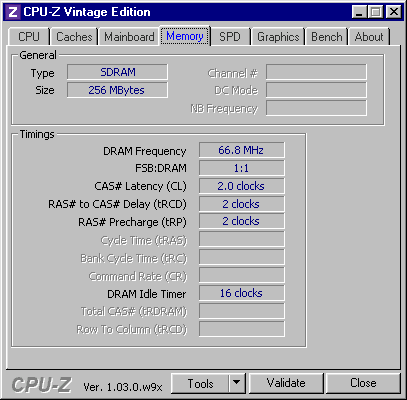

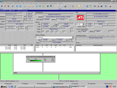

Reply 657 of 783, by Takedasun
Incorrect GPU frequency, it should be 75 Mhz
The attachment hwinfo.png is no longer available
and memory timings
The attachment timing.png is no longer available
Reply 658 of 783, by Mumak
Takedasun wrote on 2023-04-20, 12:30:
Incorrect GPU frequency, it should be 75 Mhz […]
and memory timings
Thanks. Memory timings will be fixed in the next build. But not sure how to fix the GPU clock. This card seems to be using a different clocking path (SCLK HCLK direct).
