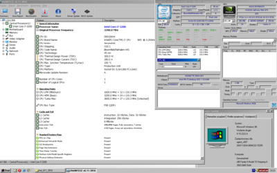

Reply 36 of 785, by agent_x007
i7 965, wrong name ?
The attachment HWINFO i7 965.png is no longer available
I added raport as well.
PS. 7800 GTX has 16ROPs and 24 Pixel Shaders.
Reply 37 of 785, by Mumak
agent_x007 wrote:
i7 965, wrong name ? […]
Thanks. That's because of Win98.
To identify a CPU HWiNFO doesn't rely on the CPU name string (which can be faked sometimes), but on certain factors. An since Win98 doesn't have MPS support, the number of cores is limited, which causes the mismatch.
I think that GPU parameters might be wrong because it's not properly initialized due to the driver lack.
