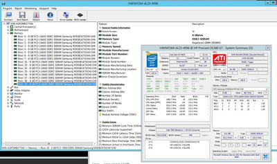

CoffeeOne wrote on 2020-03-01, 13:10:
Sure. Now there are temperatures for the first 32 DIMMs hw-info-4094.jpg […]
Mumak wrote on 2020-03-01, 13:03:
CoffeeOne wrote on 2020-03-01, 12:01:
Sure, Looks quite good, but I can't find DIMM thermal sensors. Did I overlook it?
In the attached zip file, there should be the debug file and the htm report.
Please try again with: www.hwinfo.com/beta/hwi64_623_4094.zip
Sure.
Thanks. Looks like there's some issue with the SPD mux, a problem might also be concurrent running of HWiNFO + SIV.
I did a few more updates, can you please try again: www.hwinfo.com/beta/hwi64_623_4095.zip

Reply 184 of 683, by CoffeeOne
Mumak wrote on 2020-03-01, 17:01:
CoffeeOne wrote on 2020-03-01, 16:14:
I confirm that SIV ran before hwinfo. Also that time I ran version 4095 and saw temperatures for all 64 DIMMs, yay. debug info a […]
Mumak wrote on 2020-03-01, 14:29:
Also that time
debug info and report zipped attached
Could you please make one more try using: www.hwinfo.com/beta/hwi64_623_4096.zip
I'd like to test one more improvement, but not sure if that will work as expected.
Nope, that's not good:
288.25 KiB
1045 views

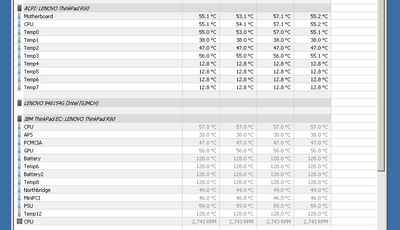

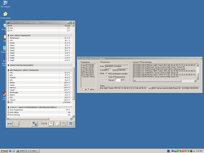

Reply 188 of 683, by vorob
Sir sir... I've got another laptop with tremendous amount of bugs in HWINFO. IBM ThinkPad R60.
First of all it doesn't report any memory slots in summary windows. In detailed window it reports huge amount of ram slots while in reality its just 2 slots with 2x2gb ram
Then i'm getting this sensor warning. Anything can be done here?
And when i open sensor window i've got one section without titles, and second part with some wrong values like over 100C...
p.s. it is possible to control fans via some custom fan-made utility, any way to add this functionality here?
    HWiNFO32.rar

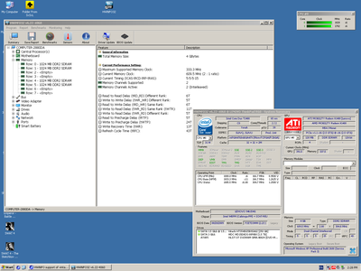

Reply 189 of 683, by Mumak
vorob wrote on 2020-03-02, 12:35:
Sir sir... I've got another laptop with tremendous amount of bugs in HWINFO. IBM ThinkPad R60. […]
This machine blocks access to DIMM SPD memory, hence it's not possible to provide detailed module information. What you currently see is only the logical memory configuration, not physical modules.
That warning window is just a warning (self explained), you can disable it from appearing.
I will remove the invalid sensor values in the next build.

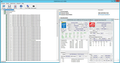

Reply 191 of 683, by CoffeeOne
Mumak wrote on 2020-03-02, 15:18:
Ready for yet another test? ;) This will be a special one - attempting to access the 7500 Scalable Memory Buffers for the first […]
CoffeeOne wrote on 2020-03-01, 18:25:
Mumak wrote on 2020-03-01, 18:01:
That looks good again.
What do you think about the DIMMs with wrong SPD data? Anything to worry about?
Ready for yet another test? 😉 This will be a special one - attempting to access the 7500 Scalable Memory Buffers for the first time.
Since I haven't tried this before, I don't know if it will work. But if it does, we should be able to read additional memory parameters including the Memory Buffer temperatures.
Here the test build: www.hwinfo.com/beta/hwi64_623_4098.zip
Yes:
Seems to be nearly as good as 4095 😁
318.5 KiB
992 views
There are special characters in the DIMM names, that's new.
But joke aside, what should be shown additionally?

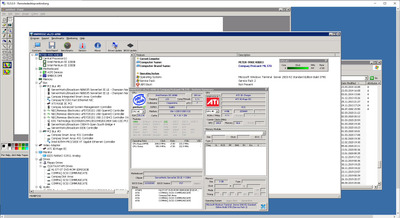

Reply 192 of 683, by CoffeeOne
My hwinfo try on the Compaq Proliant ML370:
292.19 KiB
988 views
Impressive. So please add SPD Info 😁
Have to check what's missing, but looks really good
Reply 193 of 683, by Mumak
CoffeeOne wrote on 2020-03-02, 20:33:
My hwinfo try on the Compaq Proliant ML370: hwinfo-ml370-main.JPG […]
Thanks 😀
The problem with missing SPD is because this machine has ServerWorks OSB4 chip and it doesn't seem to have SMBus enabled, which is required to access SPD.
And since I don't have documentation for this chip, I don't know how to enable SMBus there 🙁
I'll get back to you regarding the issue on Xeon X7 shortly...

Reply 195 of 683, by vorob
I think ACPI: LENOVO ThinkPad R60 and IBM ThinkPad EC: LENOVO ThinkPad R60 report the same data, but second thing makes some errors. I was looking at second sensor in OSD and sometimes GPU temperature were 128C, and cooler RPM was much more then i could be.
I used another tool to compare data, and looks like that in ACPI: LENOVO ThinkPad R60
Temp 1 - APS
Temp 3- GPU
Temp 2- CRD
Sad thing is that fan rpm is in "broken" sensor part...
Other things are not important from my point of view.
What is LENOVO 946154G (Intel (G)MCH) with no data?
    67.45 KiB
    946 views
Temp 1 - APS
Temp 3- GPU
Temp 2- CRD
The "Intel (G)MCH" item is the chipset sensor, but it doesn't provide valid data on this system.
Reply 197 of 683, by Mumak
CoffeeOne wrote on 2020-03-02, 20:14:
Yes: Seems to be nearly as good as 4095 :D hwinfo-5098-main.jpg There are special characters in the DIMM names, that's new. […]
Yes:
Meanwhile I have 2 new builds, would be great if you could test both and provide results as I'm not sure which method will work better. Here they are:
- www.hwinfo.com/beta/hwi64_623_4099.zip
- www.hwinfo.com/beta/hwi64_623_4100.zip
Sorry for so many requests, but it's difficult to develop/test such system remotely. We (I and Ray) were already considering buying such machine, but none of us is yet keen on spending several hundreds of EUR just for a couple of days of testing...

Some good news for elder geeks 😀
HWiNFO32 version 6.23 Build 4105 Beta finally brings back support of Windows 95. Tested was OSR2, note that some GUI controls might require installing IE4 (OSR 2.5).
