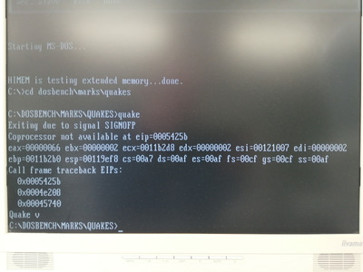

Reply 252 of 683, by phantom_pl
Mumak wrote on 2020-04-16, 06:43:
As for the 486SX - does the machine perhaps have an FPU ? In the previous test HWiNFO reported no FPU, now it looks as if there was one.
Quake definitely claim there is no FPU, and refuses tu run
    1001.08 KiB
    898 views
Reply 253 of 683, by Mumak
phantom_pl wrote on 2020-04-16, 06:59:
Please try to run with Method 1 disabled if it will still show 486DX or SX perhaps.

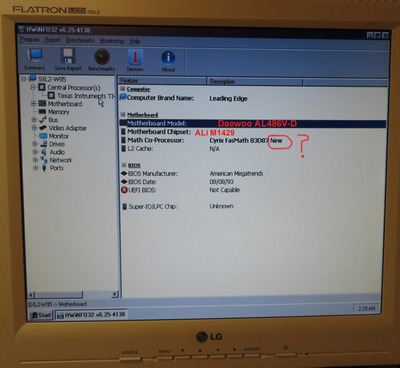

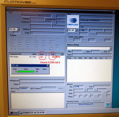

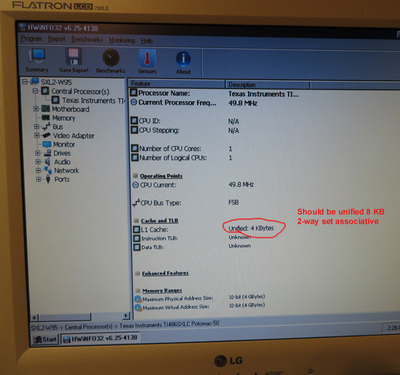

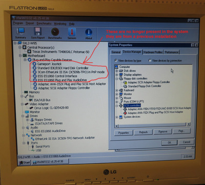

Reply 259 of 683, by feipoa
Motherboard is a Daewoo AL486V-D, aka Panda 386V.
SXL2-50 running at 2x25 MHz with Cyrix FasMath CX-83D87
See comments in the photos.
132.94 KiB
824 views
138.46 KiB
824 views
216.46 KiB
824 views
177.1 KiB
824 views
