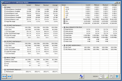

Tried HWiNFO32 on my Dual Pentium Pro build (not done yet).
- Some DIMMs are recognized as FPM (should be EDO)
- Temperatures and other sensors have strange values
- Audio is not fully recognized (listed as Unknown or none, but devices are present)
- In SMBIOS DMI the L1 and L2 cache are listed but have no title (this might be just the way it is)
- Serial ports are disabled in BIOS, but still found by HWiNFO32. But Windows 2000 also assumes they are there in Device Manager with the yellow exclamation marks
Thanks for keeping retro-HWiNFO alive!

Reply 533 of 683, by Mumak
Cyrix200+ wrote on 2021-10-20, 12:39:
Tried HWiNFO32 on my Dual Pentium Pro build (not done yet). […]
Thanks for the feedback. Please also attach the HWiNFO Debug File, I need to check more details.

Reply 534 of 683, by Cyrix200+
Mumak wrote on 2021-10-20, 13:23:
From a quick look - the BIOS also reports 2 modules as FPM in SMBIOS DMI. The L1/L2 info in DMI is populated by BIOS.
I have reset the BIOS settings between my previous post and this post. I've attached the debug file and a new log file.

Reply 535 of 683, by Mumak
Cyrix200+ wrote on 2021-10-20, 14:49:
Looking at the raw data, the memory controller is indeed configured so that the last rows are in FPM mode. Could be a BIOS issue.
Reply 536 of 683, by Cyrix200+
Mumak wrote on 2021-10-20, 17:17:
Ha, the memory controller was actually right. The DIMMs are FPM: https://www.servers4less.com/memory/server/mi … shi-mh4v72czj-6
FPM is not (officially) supported by the board (http://www.win3x.org/uh19/motherboards/3172), so I had assumed it was EDO memory.
1.4.1 Main Memory The motherboard has four DIMM sockets. Minimum memory size is 16 MB and maximum memory size is 512 MB. The m […]
