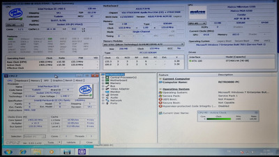

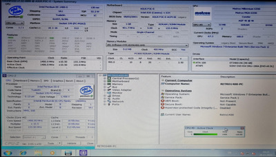

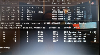

After integrating Tualatin microcode to the bios.
<BIOS:> BIOS update data incorrect. --> Line disappeared! Good.... 😀

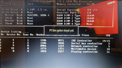

Reply 141 of 394, by karakarga

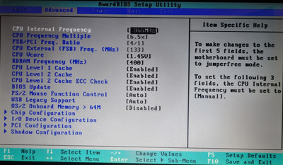

But, bios still reports processor being 866MHz for the Pentium III Tualatin 1400-S CPU. This has not changed!
Reply 142 of 394, by karakarga
Hardware info was giving correct information, before and after.
Applying the Tualatin microcode inside the bios, only become good for the error message at the boot screen!

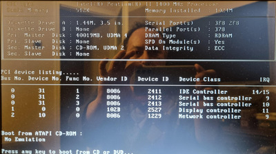

The boot screen freezes at just before memory check: GA-6BX7.jpg […]
I checked the VRM and frequency generator chips and they can provide voltages down to 1.3V and up to 150MHz FSB with no issues.
The above photo is for SL64V (Intel Celeron 1.4 GHz) CPU, the board provides the right voltage (1.5V) but wrong FSB (66.6MHz x 9.5 =633MHz). The 9.5 multiplier is the max supported by dip switches but that shouldn't be an issue IMHO.
I can confirm the board works nicely with lower frequency CPU's at 100MHz FSB with no issue, but gets confused with the tualeron one.
It does exactly the same with SL6BY (Intel Pentium III 1.4GHz-S).
Hmm ... that might indeed be anything. By any chance, have you tried the BIOS patcher from rom.by? If it's a known problem of Award 4.5-based BIOSes, it might do the trick.
Reply 144 of 394, by DenizOezmen
karakarga wrote on 2022-11-26, 12:45:
How can we extract the microcodes of the original bios file to see, what is in?
There are various tools to help with that: CBROM for extracting the microcode module, and e.g. ctmc or MCExtractor for listing the microcodes inside.
karakarga wrote on 2022-11-26, 16:13:
Yes, that is expected. Thats's why I asked "Just the microcodes?" in reply to your request. 😉
Most of the other fixes listed in the first post require disassembling the relevant parts of the BIOS code and writing patch code -- much more work.
The P3C-E uses a slightly different build than the boards listed in the first post, so patching it completely would not be a "copy/paste job".

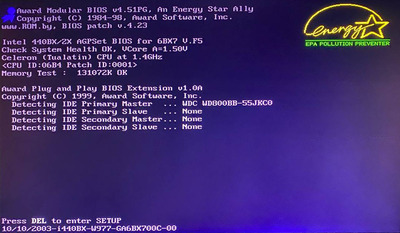

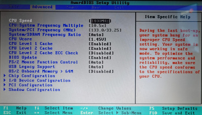

Reply 150 of 394, by a_h_adl
DenizOezmen wrote on 2022-11-26, 18:04:
BIOS Patcher worked like a charm! now my Gigabyte GA-6BX7 is a member of Tualatin league! Thanks for bringing up this solution to me.
SL64V (Intel Celeron 1.4 GHz):
168.99 KiB
1480 views
SL5XL (Intel Pentium III 1.4GHz-S):
155.88 KiB
1480 views
I have no idea why but the motherboard kept giving me strange error codes. It took me a couple of hours figuring out only CBROM v2.07 fixes that issue.
If anyone wants to use the Patched Gigabyte GA-6BX7 I have attached it below:
