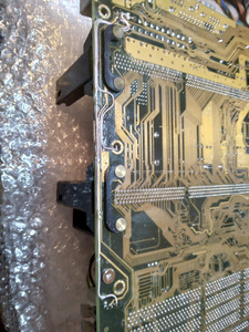

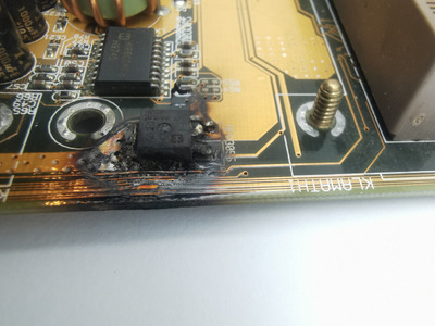

PS. Currently I'm repairing the ASUS P2L97-DS after severe damage.
Oh, a dual board. What happened to it?

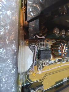

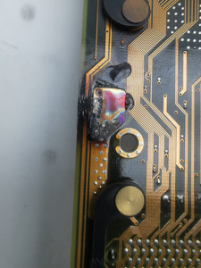

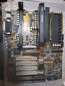

Board just caught fire under the linear stab transistor, probably due overheating (maybe some
person installed VGA card with big current on 3.5V line). I've bought board with this damage already.
I found interlayer closure between +5V and GND line. Currently I've deleted closure, cleaned cinder
and repaired print ways over and under defect place. Both transistors of linear stabilizer I've deleted
and take 3.3V power from ATX connector. Board started!! But I also found bad capacitors on it (swelling
and leakage). Currently I'm doing full recapping my board. Later, I hope to show the photos of my board.

I want to show the photos of my P2L97-DS, that I mentioned earlier
Before repairing
258.7 KiB
1601 views
298.05 KiB
1601 views
After repairing
1.61 MiB
1601 views
1.74 MiB
1601 views
1.37 MiB
1601 views
I hope to run it with two CPU's.
