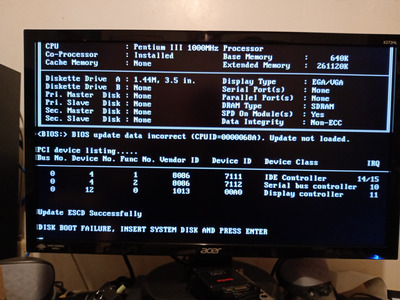

DenizOezmen wrote on 2023-06-16, 09:18:
Have you tried your CPU in the P2B? Is there anything specifically amiss (aside from the fact that the POST screen will call it a "Pentium III")?
It's missing the microcode for it, eventhough it displays it properly:
426.28 KiB
1116 views
"BIOS update date incorrect (CPUID=0000068A). Update not loaded."

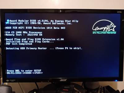

mockingbird wrote on 2023-07-02, 20:11:
That message is at the same time correct and misleading: Via C3 CPUs don't support microcode updates at all. The BIOS tries to find a "matching" Intel microcode update to load into the CPU. (It's good that it doesn't find any; in the worst case, the machine might lock up.)

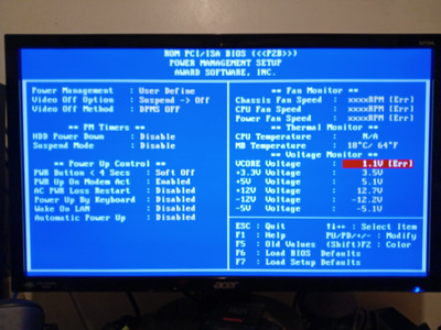

Reply 272 of 394, by mockingbird
DenizOezmen wrote on 2023-07-04, 19:15:
Here's something to test, for both P2B variants (with or without hardware monitor).
In case your board supports hardware monitoring: Could you also check whether the VCore reading in Power Management Setup seems sensible?
Kudos, kudos, thank you, thank you. Not only is the microcode error gone, but the CPU now displays properly on POST.
vcore is showing an erroneous reading now -- you're right. It did work properly before. The fan also has the high divider like the stock P3B-F BIOS, so the fan speed is too low to register (If you feel like it, I'd appreciate it if you could modify it to the lower divider if it's not too much trouble).

Reply 273 of 394, by DenizOezmen
mockingbird wrote on 2023-07-05, 01:22:
Glad it works, thanks for testing!

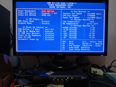

Reply 274 of 394, by mockingbird
DenizOezmen wrote on 2023-07-05, 16:18:
Thanks for double-checking. My P2B-F might have a defect, so I wasn't entirely sure what to make of that. In the end, the erroneous VCore reading was caused by a bug in the mod and should be fixed now. The fan dividers have also been changed to accomodate slower fans. (I've set the warning thresholds to ca. 900 RPM for all fans.)
Beautiful, fantastic. Fan speed is showing and voltage is correct. The only thing that's an issue is your detection algorithm (and your previous 07/04 release had this issue as well)... If I put an Intel CPU in now, it POSTs, but doesn't make it past post. The post screen finishes loading, the screen goes blank, and then...nothing. Might I recommend two seperate releases, one for VIA and one for Intel if you don't manage to figure that out. As always, I am glad to test for you either way. To be honest, I'll only ever use this board for VIA. I need it for its specific clockgen chip, and I have other, superior boards for Intel CPUs.
