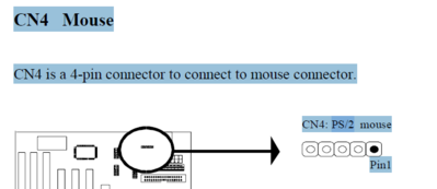

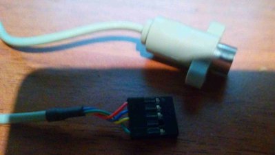

i bough Lucky star 5mvp3 4.0 SS7 MB, i have problem to get PS/2 mouse to run.. it arrived without PS/2 header, so i salvage one from other machine (where it was working fine), but wiring is probably not compatible, i didnt found PS/2 mouse Bios option is probably always enables.. or dead, if is not problem with wiring, but i doubt it.
In manual is only very bad description of header connector..

My cable:

I think that header is pretty standard, but I could be wrong. Here's the pin out for my MB-8500TTD:
An image I found on the web:
When in doubt, use your volt/ohm meter and measure. When I bought a cable for the PS/2 port for my MB8500, I had to redo the wires and verify them with a pin/ohm meter because the wire colors weren't standard.

I did some clumsy measurement with voltemeter (i have this electrical and soldering, not computer stuff) if resistence is small or not.
I seems that these are connected:
PS My Cable MB end \ Right side of your PS/2 diagram front connector.
Red=Data
Blue=Clock
Yellow=GND
Green=Vcc
So wired it as for you MB header reagarding of diagram, if im not wrong its (MB connector color):
Pin 1 - red
Pin2 - nothing
Pin 3- Yellow
Pin4- Green
Pin5 - Blue
Still nothing, so my MB header is maybe wired by other way.
I really dont know how to measure MB pins.. on connected its simple there is just 1 cable and i need to find right ends, but on MB?

checked a few manuals and the Shuttle HOT-553 has the Data and Clock (pins 1 and 5) swapped on the motherboard connector compared to the image Repo Man11 posted, the others pins are the same.

Try this:
1. Mouse Clock
2. Mouse Data
3. Not Connected
4. Ground
5. VCC
It's not listed in the 5MVP3 manuals that are still available, but there is a valid pinout in the 5MVP4 manual:
http://www.elhvb.com/mboards/luckystar/manual … 4/5mvp4_v10.pdf
Reply 10 of 11, by Tiido
On one luckystar motherboard I determined the pinout to be what is found here : LS-P54CE Rev:G1 mouse connector pinout
Looks like yours except Data and Clock are reversed.
