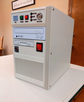

Reply 101 of 112, by wiretap
I have the 2-digit in my 3D printed case.

Reply 104 of 112, by Raynex
wiretap wrote on 2022-11-09, 02:28:
How in the world is that 3D Printed? I can only confirm it is from the marker on the lettering. Did you sand like your hands were about to fall off before priming and painting it? That is beautiful and something I've never considered. Have a link to the design (assuming it's open to the public).

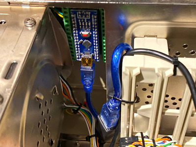

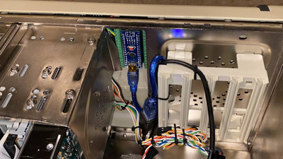

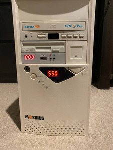

When I did that display about two years ago I never thought someone would like to know more about it so I haven't documented anything yet. But I'm pretty sure most of you have already figured it out what I have done. It's basically an I2C display using only 4 wires from arduino. You can find more about it from here:
https://create.arduino.cc/projecthub/ryanchan … tutorial-ca8a93
I created a YouTube channel just for uploading a couple of videos of my two cases which I have already installed TM1637 on them. I personally prefer the original display but these two cases didn't have any so I went ahead and did them on a Saturday afternoon. The installation and the programming is so basic. Here is a photo of one case and the inside as much as it lets me to show:
157.61 KiB
1025 views
134.74 KiB
1025 views
119.65 KiB
1025 views
And the videos:
https://youtu.be/Aa9yrToP6V0
https://youtu.be/8yAOuXALf_o
The first PC is a Pentium 233 and the second one is a K6-III+ 550 so none of them uses the turbo mode so it hasn't been implemented. I will make a third one when I have some time in a couple of days showing wirings and also including the turbo switch functioning.
