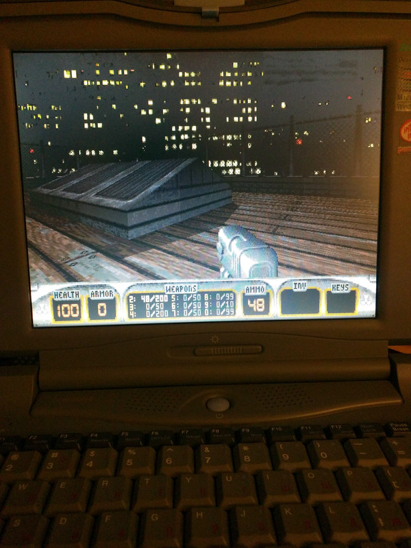

Reply 241 of 1075, by MAZter
Got this beast today, beauty laptop!
Samsung Sens 800
1997 year
Pentium 90
10.4” TFT 640x480
Cirrus Logic GD-754X
8 Mb
Hitachi DK212A-10 1Gb
ES 1488 (SB 2.0, Adlib, ESS Audiodrive)
Made in Korea
Doom is what you want (c) MAZter
