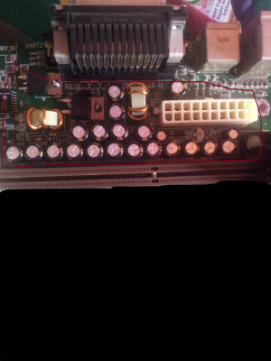

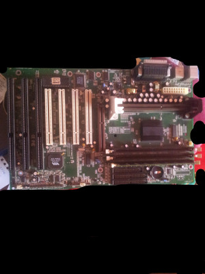

i have a qdi advance 5/133 slot 1 motherboard that wont post when its components are cold it beeps like there no ram in the ram slots. when i let the mobo get warm a little or if i personly heat the area near the cpu the one with lot of capacitors with a hair dryer it will post. then boot to windows 98 and i can play without problems even 3d games. what can cause this? caps? cold solder joints?

    area that after i heat the mobo will boot

    motherboard whole photo

No, that original poster is right track of diagnosis, capacitors when they start to fail, will perk up when heated. Replace them.
I know this from my electronic repair background, seen this all the time and I do have a specialized tool to measure ESR of capacitors get lower (low ESR is good, high ESR is no good), when capacitor is lightly warmed.

thanks for your posts. truth is this mobo is 20+ years old. it was given to me for free and i dont know about how it was treated or stored. now it is known that a capacitor can fail even if shown visually ok just like in my case. heat can restore some capacitance and esr levels, but sold solder- crack solder isnt something uncommon. i will flux and solder fresh the components in the suspicious area, that wont hurt and if same things happen after that, whitch is most likly i will recap it
Reply 5 of 23, by truemaster
ok guys i refresh the solder on components on the suspicious area. and same thing happening. looks like im gona need recap im thinking of replace all large 1000mf 6.3 volt (some are away from cpu but are same as the ones near)
i have a shop near my house that sales lelon low esr caps. im looking for a repair that will last although im not working this retro pc everyday and i dont leave it open overnight but i am willing to do as good as i can. what your thought about the replacement? the original caps are from licon.
