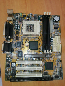

I picked this motherboard up at the flae market today very cheap €3 Its an ECS P6EXP-Me motherboard, socket 370, 1x AGP, 3x PCI, 1x ISA. I don't know if it is working but physicalkly it looks very good and clean
I did a bit of googling and I can't find what CPUs this supports, other than 'Celeron'.

Depends on which type your 533 Celeron is. Only the PPGA Mendocino version will likely run on your ECS board. You can find the details here and there are photos when you scroll down:
http://www.cpu-world.com/sspec/SL/SL3FZ.html
The later version is FCPGA Coppermine with green plastic and that will most likely not run.

In any event this is the i440EX chipset, so max 66MHz FSB in-spec and if you're lucky 83MHz OC. Also max 512MB RAM in total (or rather: 2 double-sided DIMMs, or 1 double+2 single-sided - if the chips are less than 128Mb, capacity will be similarly less).
In any event, it will be a PPGA socket. You can mod it to FC-PGA (Coppermine), but then you still need to do something about voltages and BIOS. Basically this is the archetypical Mendocino Celeron board.

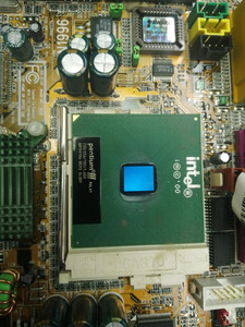

Just to clarify the faulty SIO is on another motherboard I got last week (actually got a complete white PC tower in nice condition), I am sure that is a P3 533 though i don't know which type because I didn't remove the heatsink from the CPU yet. There is a sticker on the back of the tower with the spec printed on it which says PIII 533 so that will be what it is because the rest of the spec seems to match the sticker. I don't recall which motherboard it is either but it's an unusual looking one. It is a mini ATX board, has 3x PCI and what I thought was an 1x AGP until I realised it had a modem card plugged into the rear half of it and it's like 2 smaller brown CNR type connectors in line with each other. I will post some pics of that tomorrow as I have not seen such a thing before.
When i say the SIO is short, actually the PC will not start up at all (the ATX PSU does not get the turn on signal even though I have 5V on the start button pin. If i force the PSU on then I get 0000 on my post test card. I worked out it is the SIO which is faulty because the CMOS battery was completely flat like 0.02V which is unusual. So I used my bench PSU to supply 3.2V to the battery connector and checked with my multimeter on uA range to see how much current it was drawing. A good SIO normally draws about 1-3uA when the motherboard is powered off. This one goes to OL on the 200uA range. I don't have the correct variant SIO chip (W83627F-AW) in stock so I have ordered some.
So in the meantime I was wondering if I can use that CPU to test this motherboard, as I don't have any other Socket 370 CPU in my stash of goodies. I guess from the replies, this will depend on exactly what the CPU is. I think it is the green type with a glass die in the middle.

Fastest celeron you can run in that is 433. thats also probably the fastest cpu that will run without some kind of mods or adapters.
Your board is 66mhz

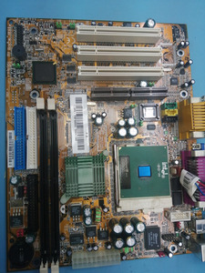

This is the motherboard that has that weird slot on it. The motherboard manual says it is an AMR and a PTI slot. I never saw one before. It also says this is a Micro ATX WH5 motherboard. What does that mean?
See pics.

No idea what the "WH5" means. It looks like an MSI MS-6178 to me, which is uATX all right. Also complete i810-crap, so if it is dead, not a major loss.

Yeah it is an MSI and 6178 sounds about right though I'm not at the workshop now to check. It has a faulty SIO. I've ordered some of the correct type. I am fixing as many motherboards as I can get my hands on at the moment as I am teaching myself how to repair them, from 486 boards to Z390 gaming boards.
The cost of the parts are worth it to me in the experience gained and any I do fix I either keep as test boards for a certain socket type or RAM type or sell to then buy more stuff to fix and test gear to fix them with .
