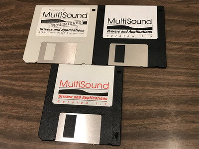

Reply 1 of 17, by boxpressed
This post includes all the drivers and associated applications I own (other applications to follow in another post).
The collection of MultiSound drivers for Windows 3.1 currently on vogonsdrivers.com (courtesy of user bristlehog) are Version 2.0. I have Versions 1.0 and 1.1, as well as a "Preliminary" disk that contains files not found on any of the driver sets. I believe that it is supposed to be loaded first when adding the MultiSound driver in Windows 3.1.

msprelim.7z
129.88 KiB
45 downloads
driver10.7z
268.67 KiB
43 downloads
driver11.7z
337.09 KiB
43 downloads

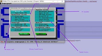

I also saw an old Sierra manual that looked quite generic but that I think came from Space Quest IV. It mentions support for the MultiSound.
I have checked Space Quest IV, but all three versions I have - 1.060, 1.111 and 1.996, have no signs of Multisound support.
Version 1.060 only allows music card to be selected:
66.61 KiB
1449 views
Version 1.111 just adds 'Tandy 2500XL' option to those of 1.060.
Version 1.996 allows both PCM and music cards, but the list is pretty different:
134.77 KiB
1448 views
Hardware comparisons and game system requirements: https://technical.city

This Space Quest IV fan site mentions a patch that fixes a problem with the MultiSound: https://www.spacequest.net/sq4/patches/
Reply 8 of 17, by bristlehog
boxpressed wrote on 2020-01-21, 05:46:
This patch will prevent a lock up problem when the "zombie" screams if you have a Turtle Beach Multisound card or another sound card that doesn't support variable sound sample rates through Windows.
Seems it concerns only Windows 3.1 version of the game, not the DOS one.

bristlehog wrote on 2020-01-21, 09:44:
Yes, I believe so. Doesn't this still mean that the Proteus is generating the MIDI music, however?
I found the PDF of the game manual that mentions the MultiSound (see p. 6). When you install the game in Windows, the setup asks you to select "Base Level MIDI" or "Extended Level MIDI." Base is for SB & PAS, while Extended is for GM sound Sound Canvas, MultiSound, WaveBlaster, and Yamaha TG-100.
https://www.mocagh.org/sierra/sierra-manual-alt5.pdf
I have the SQ4 CD-ROM v.1.0, and this is what the MIDI setup screen looks like:
Here's what the zombie crash screens look like:
