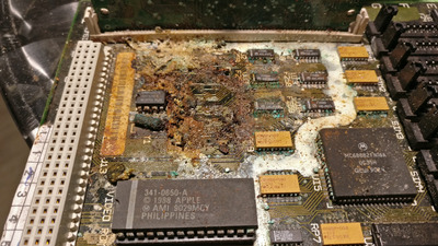

I once had a SE/30 showing similar patter. Once opened the board looked like this:
download/file.php?mode=view&id=75016
So don't bet on this one. It can be anything from bad caps to half of the motherboard being destroyed.

Yeah, except the SE has zero SMD caps, only throughhole axials.

No, but you can never tell what is in the PDS slot or which motherboard is actually in (SE and SE/30 are interchangeable) 😀
Anyway, I think the battery damage has potential to be far worse than caps. It literally eats things out.

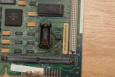

mpe wrote on 2020-01-21, 12:32:
The SEs belong in horror movies, this is a photo from some local FB group:
572.84 KiB
896 views
So yeah, be extra cautious when buying one.

I had a Mac Classic that's like that. i took it apart thinking it was just the typical leaky caps issue but it was much worse, the battery has leaked. i just chucked it, it was no use. got a Mac IIci to replace it. the IIci only had bad caps but i cleaned it and recapped it and it's now working.

My understanding is that it's the Varta batery that basically melted itself onto the logic board, I passed on the offer..
