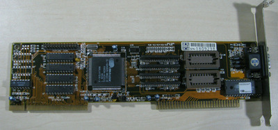

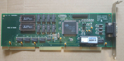

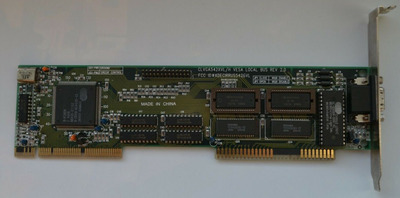

I have a Cirrus Logic 5428 and 5429 video card that I would like to add more ram to to turn it into a 2mb card.

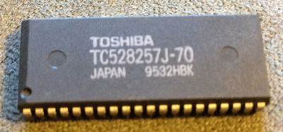

My question is will these ram chips work in these card ?
Toshiba TC528257J-70 CMOS FP DRAM, 2 M-bit (256 k x 😎 70ns

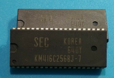

What about these ?
2 PCs of KM416C256-7 or 2 PCs of HY514264-70 256Kx4 DRAM (SEC/HYNIX)

Reply 5 of 17, by mpe
You need two 256Kx16bit FPM chips to upgrade this. The one you have is 256Kx8
That's being said this is a pointless upgrade on CL-GD542x series as it only enables two extra interlaced resolution modes and no other benefits.

Reply 10 of 17, by dionb
One step back: *why* do you want to upgrade this particular card?
GD5428 can accept 2MB, but are very limited in what you can do with it, it just gives you a few extra interlaced modes and no extra resolution or colour depth 😮
I've been trying to upgrade a 5428 purely for the soldering challenge of doing so - but don't expect any tangible benefit. If you want to run 1024x768x16b or 80x600x24b, you need a different card/chip.
