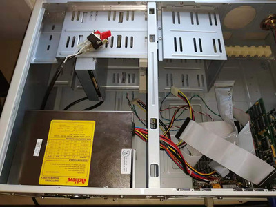

Hello guys. I recently got a full sized AT Power Supply from e-bay for my ridiculously oversized case for my 386
It's an Archive AL 250 watts. Listed as used, but the thing looks near-new.
Anyway, I installed the power supply in the case. I did not connected the on/off switch to the front of the case as I'm still doing work on other components.
The power supply worked, I turned the machine on and off several times while trying to resolve floppy detection issues. The on/off switch I have just laying on it's side on top of the 5.25 internal bays (see photo)
After deciding to try a different floppy drive, I take out the old and hook one up.
Still no dice on detection so i figure it's the controller card. I go to turn off the machine by the on/off switch and ouch.... I get a nasty electric shock... could feel it pulsate through my finger if though it was only for a split second.
I immediately killed power by the surge protector and removed the power cable from the power supply and have not turned the unit back on since.

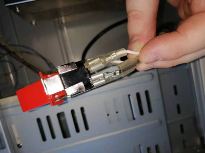

Upon checking things out this morning, I noticed that on the switch some of protective plastic on one of the wires had fallen down quite a ways (see the photo).
I am wondering now - am I looking at a potentially bad power supply? Or is the issue likely with the switch wire becoming exposed (and maybe also how I had it resting on the case internals)?
Reply 1 of 7, by DankEngihn
In AT power supplies, there is mains power (120/240v depending on your country) traveling through the switch. That's why the wires to that switch are so thick, and is why the spade connectors usually have a plastic shroud over them.
If there's a ground wire, connect it. If you don't, and something goes wrong in the switch, it has the potential of making the entire case live, and will not be a pleasant experience.

Reply 3 of 7, by derSammler
This is common if the ground wire is not connected or you use a non-grounded plug. In that case, the shock doesn't come from the live wire, but from a voltage gap between the case and ground that slowly builds up during operation. If the switch would be bad and the case was connected to live, you have a serious problem with the electric wiring in your house, because there should be a ground fault interrupter that cuts voltage before you can touch it.
Reply 4 of 7, by imi
yes, there are live wires on an AT power switch, those insulating covers are there for a reason 😉

Reply 6 of 7, by imi
a surge protector is not a safety device for you! it simply protects your device from receiving voltage spikes that might cause damage to the device.
if the live wire doesn't touch the case and trips the breaker (if the case is properly grounded) and you touch the live wire on the switch somehow you will get shocked if there is no ground fault protection.
be careful with that and watch out for proper insulation.
also I would suggest mounting the switch in the case so you don't have to hold it while using it, often there is a ground cable coming with the switch wires to mount close to the power switch.
and in either case it also doesn't hurt to check if you have proper grounding.
there is little chance to get shocked from an ATX power supply because there are no live wires coming out.

Reply 7 of 7, by SirNickity
If the rubber/plastic insulation covers aren't staying put, pull them off and add some heat shrink over those spade connectors. Bring it right up to the end, but don't cover the end so you can still install them on the switch. 😀
The second issue is, even without the ground wire on the switch cable bundle, your PSU should be connected to the case, and should be grounded, ergo grounding your case. Simple test: Unplug the PSU from mains and use a multimeter in continuity mode. Make sure it beeps when the probes are shorted to each other, then put one probe on the PSU's outer casing, and the other on the middle lug of the IEC power input socket. It should beep. Then, test between that ground lug and your PC's case. It should still beep.
If you get continuity, then your case is grounded to your PSU, which is grounded to your wall outlet, which should be grounded to earth. That means all the parasitic charge that builds up (particularly from snubbing capacitors and transient suppression stuff) should be shunted to ground, and it won't give you that uncomfortable tingle. If not, something is very wrong and needs to be addressed.
