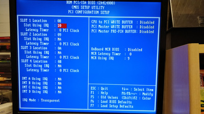

After several headaches, long hours and days, I'm coming here to see if someone has run into this issue before and can help me with it:
I recently got a FIC 486-vip-io with the purpose of having a 486 dx2 66MHz with a 2 or 4 megs PCI video card. I already have a nice SOYO vlb setup with 1mb video card, very happy with that but wanted to have a second one with better video performance, this is the set up:
Motherboard: FIC 486-vip-io
CPU: Intel 486 DX2 66MHz
Ram: 16MB
Cache: 256 Kb
HDD: Compact Flash (IDE adapter) with 512 mb
PCI video options (I have):
- 2mb Diamond Stealth64 2001 series S3 Trio64V+ (from 1995)
-4mb Diamond Stealth 3d 2000 series S3 Virge (from 1996)
The system works great with a ISA video card (Diamond Speedstar pro), the only thing that is not working is the HDD led jumper (j4) . The tower HDD led is good, It works with my vlb controller card from the other set up and the same Compact Flash adapter. This is another thing that really annoys me!.
Now, the real problem is when I switch the video card for a PCI card, I get no image, it doesn't even give me an error, I can tell the computer turns on and boots to DOS, I know this because of the floppies boot sequence and the HDD led activity of the CF IDE adapter.
I hope the mobo is good but not sure what to do with this BIOS settings:
Slot (1) using IRQ: ?? I tried 10 but nothing
PCI clock: ? goes from 0 to 255 I think
INT A Using IRQ: ??? also tried 10
IRQ MODE: ?? Transparent ? there was also Converse and something else, no idea.
CPU to PCI WRITE BUFFER: ?
PCI Master WRITE BUFFER: ?
PCI Master PRE-FETCH BUFFER: ?
There is no auto config for any of that. Is any particular IRQ these video cards use? and then, which IRQ for INT a,b, etc. I guess these also represent the PCI slots 1 -4 ? So I'm supposed to set two IRQs?, one for the slot and one for this ABC bulls@#$? Another thing is that the mobo's manual (pdf download) says it's a PCI 2.0 specification, I wonder if the video cards I'm testing are 2.1? I couldn't find any info on them, PCI 2.1 specification was released in 1995, so maybe one of the cards is no good for this set up (if not both), anyway, I still need help to figure out this BIOS settings if anyone knows.
I also set the "pull down if PCI is inserted" jumpers as the manual specifies, the only IRQ I didn't do that was the 5 which will be used for the Sound Blaster.
The copy of the manual gets cut short at the beginning of the BIOS section!, so no more help there. It really is a pain in the a$$ to switch video cards back an forth to try all the combinations!

Reply 6 of 19, by Dusko
Baoran wrote on 2020-02-17, 06:16:
I am at this moment testing this exact motherboard and it is working fine with virge/GX with bios defaults.
Bios is 4.26GN1
Jezz! so you didn't assign IRQ's and INT's ? you left them all N/A? it's driving me crazy!. I just found out that my Stealth64 2001 series seems to be PCI 2.0 which is good news but still nothing...

Reply 7 of 19, by Baoran
Dusko wrote on 2020-02-17, 06:29:
Bios is 4.26GN1
Yeah. I did "Load bios defaults" yesterday and I have not touched any of the pci settings since that.

Reply 13 of 19, by douglar
Dusko wrote on 2020-02-17, 04:35:
Good to know, I may need to get an older video card, maybe 94'. The BIOS it's 4.5G and below that says 4.26GN2 (have you seen something like that?) See the picture I posted. If you have a chance: do you know what year are the ones that worked for you? Do you have those same settings in the BIOS, how did you configure them?
I don't think manually tweaking the BIOS settings is going to help that much with correctly working PnP video cards.
I think the root cause is that the VT82C505 just wasn't 100% PCI compliant. A bios upgrade might help.

Reply 17 of 19, by Dusko
Got it working!, installed the new Diamond stealth 64 that I got from ebay and it works, don't know at what point my other 2 cards got bad, maybe got a component loose after switching them too many times, I'll inspect the circuit and try to fix them whenever I have the time latter on... anyway they're not as expensive as an ISA card. Two things that still don't work are the HDD led jumpers (J4 / J13), I want to find out what the problem is because everything else works.
Flashed the new BIOS too!! (4.27GN2A), thanks for the link! very happy with the EEprom programmer too, love playing around with it, that helped me fix a Biostar 8433uud-a that wasn't working no matter what I trowed at it, for some reason the BIOS was corrupted, installed a new chip with a new BIOS version and now works wonderfully. Inspected the old BIOS and it had some blank spaces (that can be normal) but in this case it had some letters and numbers here and there that just looked odd. Now all my mobos work! did have some very dark times dealing with them!!
https://www.youtube.com/@myoldpc9458
Reply 19 of 19, by Dusko
The problem was that the PCI video cards were bad, I didn't have to do anything to the BIOS once I installed the new good card, actually, I tested it before updating the BIOS and it was good, I only updated the BIOS just because there is a newer version and now have the tools to do it.
