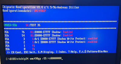

Reply 9 of 13, by Chkcpu
Hi perhenden,
Okay, this is what I like you to try.
In the attachment you’ll find the DOS-based CTCHIP34 chipset configuration tool with a .CFG file for the UMC498 chipset.
As CTCHIP34 originally doesn’t have support for the UMC498 chipset and the databook is nowhere to be found, I wrote this UMC498GP.CFG file by analyzing another UMC498 BIOS. This particular UMC498 BIOS is 64KB and therefore only occupies the F-segment. So it allows option ROMs in the E-segment and has BIOS Setup options for Enabling/Disabling Shadow RAM in this E0000h-EFFFFh memory region.
By following the BIOS code, I found the UMC498 chipset registers and bit-definitions that control Shadow RAM. For the E-segment, this appears to be reg 35h bits 7-2.
At the DOS-prompt on your IH4077H system, type the command:
CTCHIP34 UMC498GP /35
and you should see the actual reg 35h setting as programmed by the BIOS.
The bits are probably 010111xx to indicate an enabled and write protected Shadow RAM E-region. By entering the command:
CTCHIP34 UMC498GP /35:=%000000xx
You will disable Shadow RAM of the E0000h-EFFFFh memory region, allowing the BIOS ROM to be read directly from the EPROM.
Now run my Debug script again to copy the BIOS to the 2 SEG files.
Member feipoa was so kind to test the UMC498GP.CFG file on his PCChips M912 UMC498 board and this worked fine. So I’m confident this will work on your UMC board as well. 😀
Jan

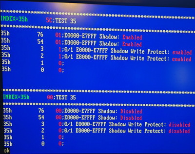

Reply 10 of 13, by perhenden
Thanks! I tried it, but the resulting seg-e.bin unfortunately has empty (nothing but FFH) contents. I made sure to delete the old .bin files first.
452.79 KiB
558 views
First command output
I tried the variations
CTCHIP34 UMC498GP /35:=%00000000
CTCHIP34 UMC498GP /35:=%00000000xx
with no difference in the result
564.63 KiB
558 views
Second command output
